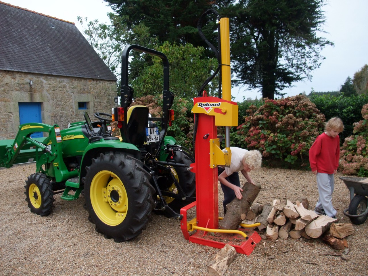

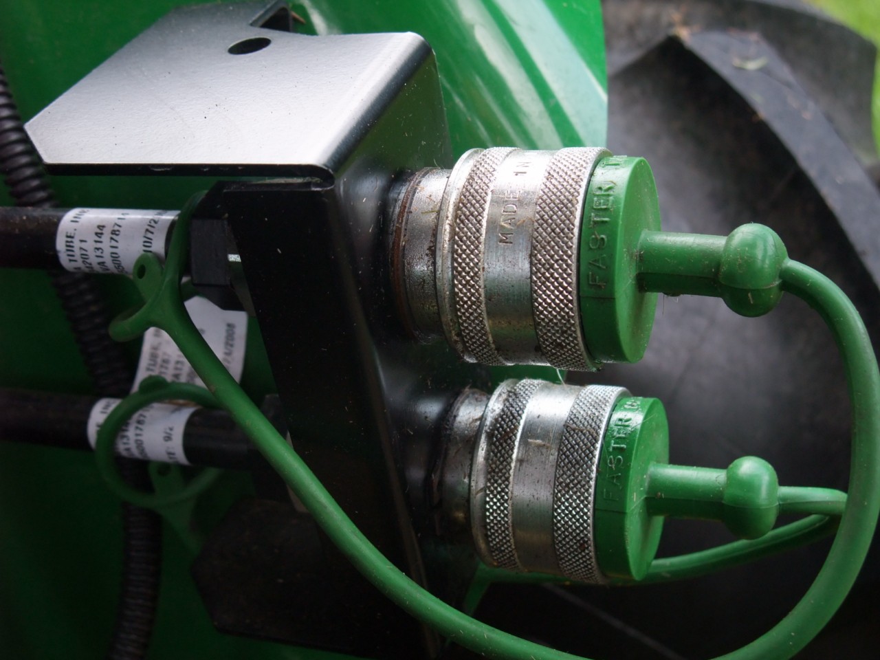

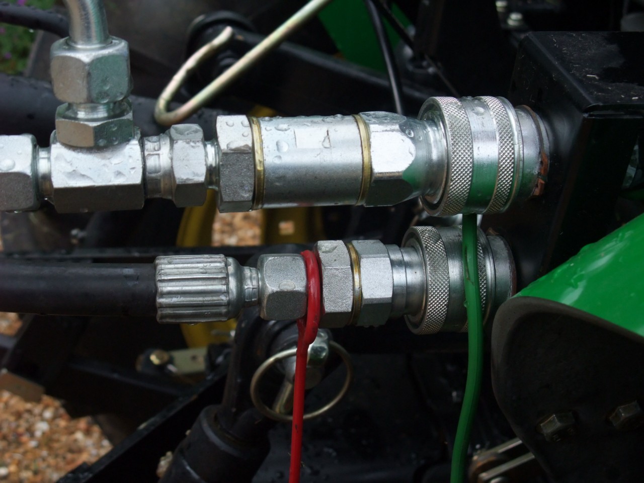

If you're mainly interested in operating a log splitter, you don't really need Power Beyond. The 3rd SVC that came standard on my 3520 does the job. This is what I use to control the log splitter and hedge trimmer. It is activated by a lever in front of the 3 pt. You cannot use the FEL or 3 point hitch while using it.
