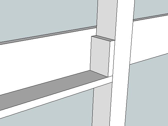

Why would the horizontal board have to go under the 2x12? Why couldn't it go next to it, inset between the posts...or even on top. It would at least keep the 2x12 from bowing even if it wasn't right at the opening.
Also, nailer blocks could be above the opening, or you could use joist hangers. I'd be tempted to use deck screws to hold something like this together, but that might be just me. Here's something like what I am trying to describe (I drew this with a 2x6 so it would be flush with the posts):
But maybe someone else knows why this wouldn't work or have a better idea.

Cool drawing. Didn't think of that. Need some long screws.
