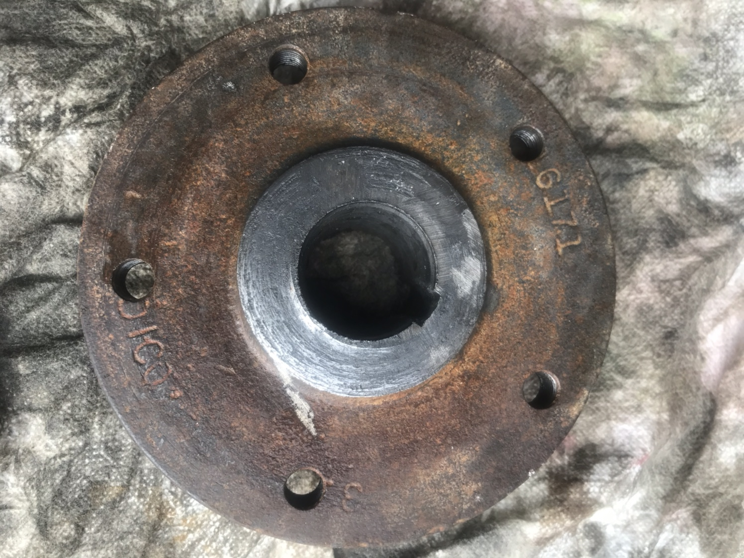

I purchased an older Wolf Pac 3100 does anyone know of a repair kit or even what wheel motor would replace this?
Maybe even just replace both and be finished with it.
Also why would the front and rear have different part numbers since the drums are the same size?
All I have is questions.

Toro bought out stone a few years ago you can still get some parts....
/ Double drum vibratory roller #15
I hopefully found the problem being the hub is wallowed out, I started a new thread about the hub.
