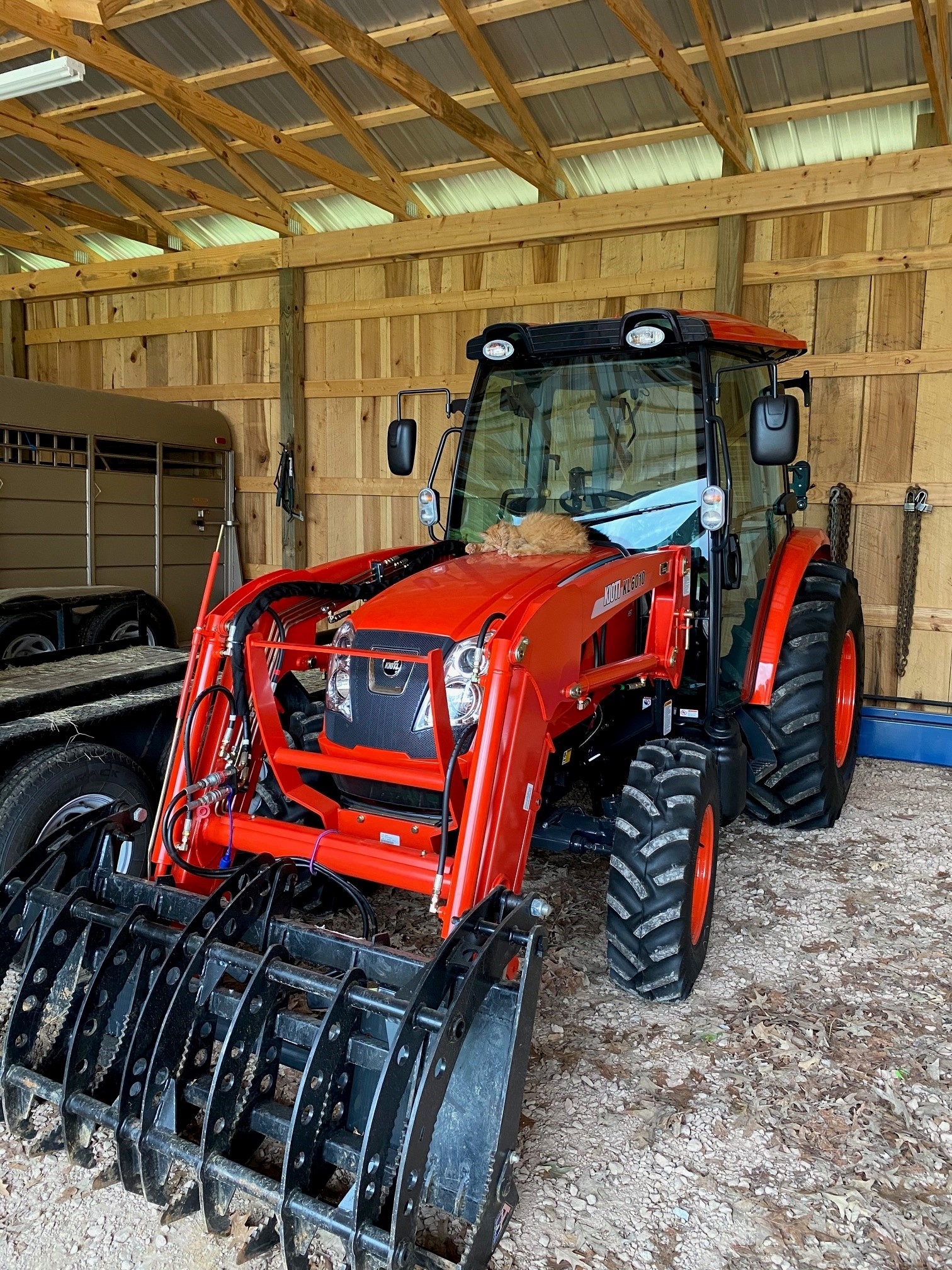

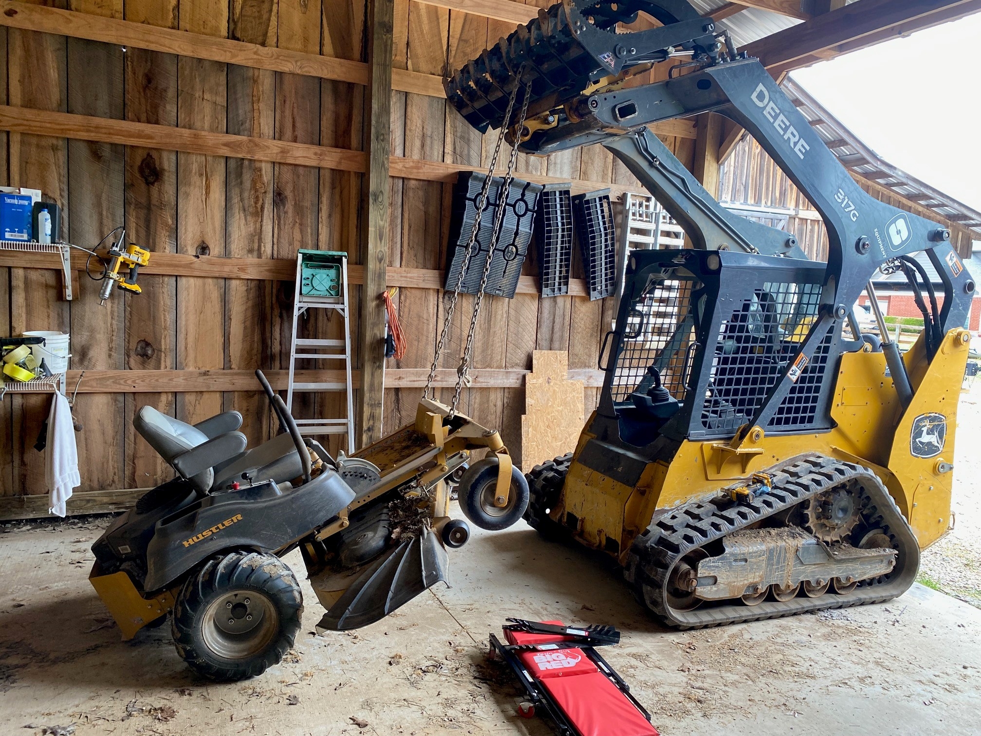

I use my EA wicked 60" on both a Kioti NX6010 tractor and a John Deere 317 track loader. It works great for me for both. Since it's my equipment and I'm the only operator and I wrote the check for it I'm certainly not trying to find the limits of what will break it but I don't tip toe around and baby it either if that makes any sense.
