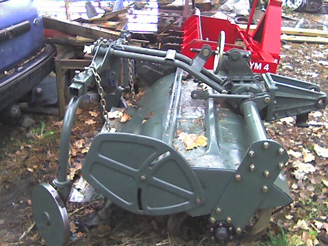

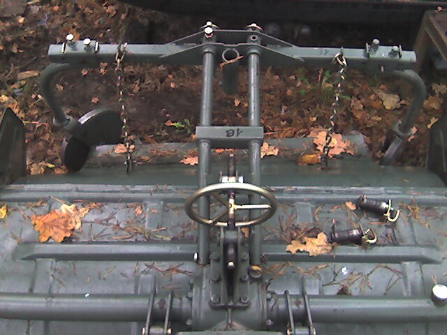

OK I took some pics today and maybe now I can better explain "o co chodzi". :eek: :D
In the pics that I saw of the KK tiller there are rear diag braces. I was thinking that you could put your pivot for your wheel mechanism behind those rather than like mine (which is right behind the box). From there the mechanism with the wheels reaches even further toward the rear and an actuating arm comes up from the pivot area but connected to the wheel mechanism. One end of the cylinder connects there and the other end connects in the 3pt tower. My Yanmar tiller has rear steel wheels. The wheels control the depth of the tiller through the action of a turnbuckle like screw. Well just look at the pics and I think that you will understand what I was thinking--Whether it is good or not is for you to decide--it is your tractor and tiller not mine. :rolleyes: :D
Let me know what you decide and how you do it. I am curious.
Mike

MJP, thanks for the pics!!
I now recognized the Yanmar tiller set-up, I've seen them before.
I was going to try to stick with the KK's original skid design, and raise and lower the skids, near or AT the point where the bolted adjuster now exists.
