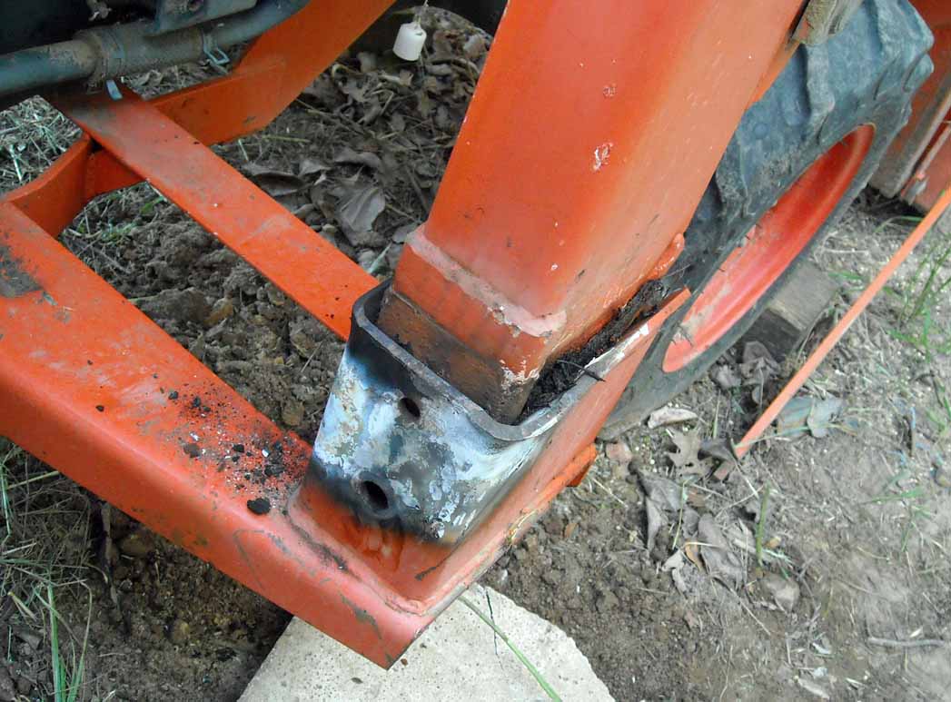

Resorting to the "universal wrench", aka acetylene torch, was inevitable. I once had to cook an FEL subframe for 1/2h with a torch to get the loader off (photo)!
