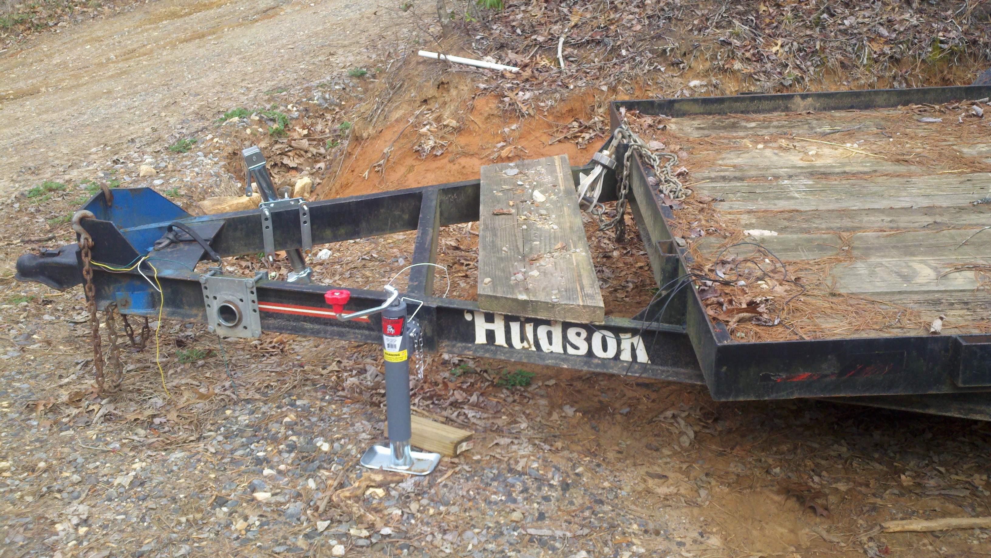

My plan for the trailer is for a 10,000lb Kubota KX121 excavator. I definately need some beef to haul that thing. The trailer is a factory Hudson tandem trailer, so I think the axle should be good. I'll check out that setup for sale. :thumbsup: Thanks.

Too dark to check right now, but I looked under the trail earlier and it all looks factory, except the "doughnut" hub and rims. I though it was odd when I bought the trailer. Better bit the bullet to beef the trailer and not lose an excavator going down the road. I'll post an update.

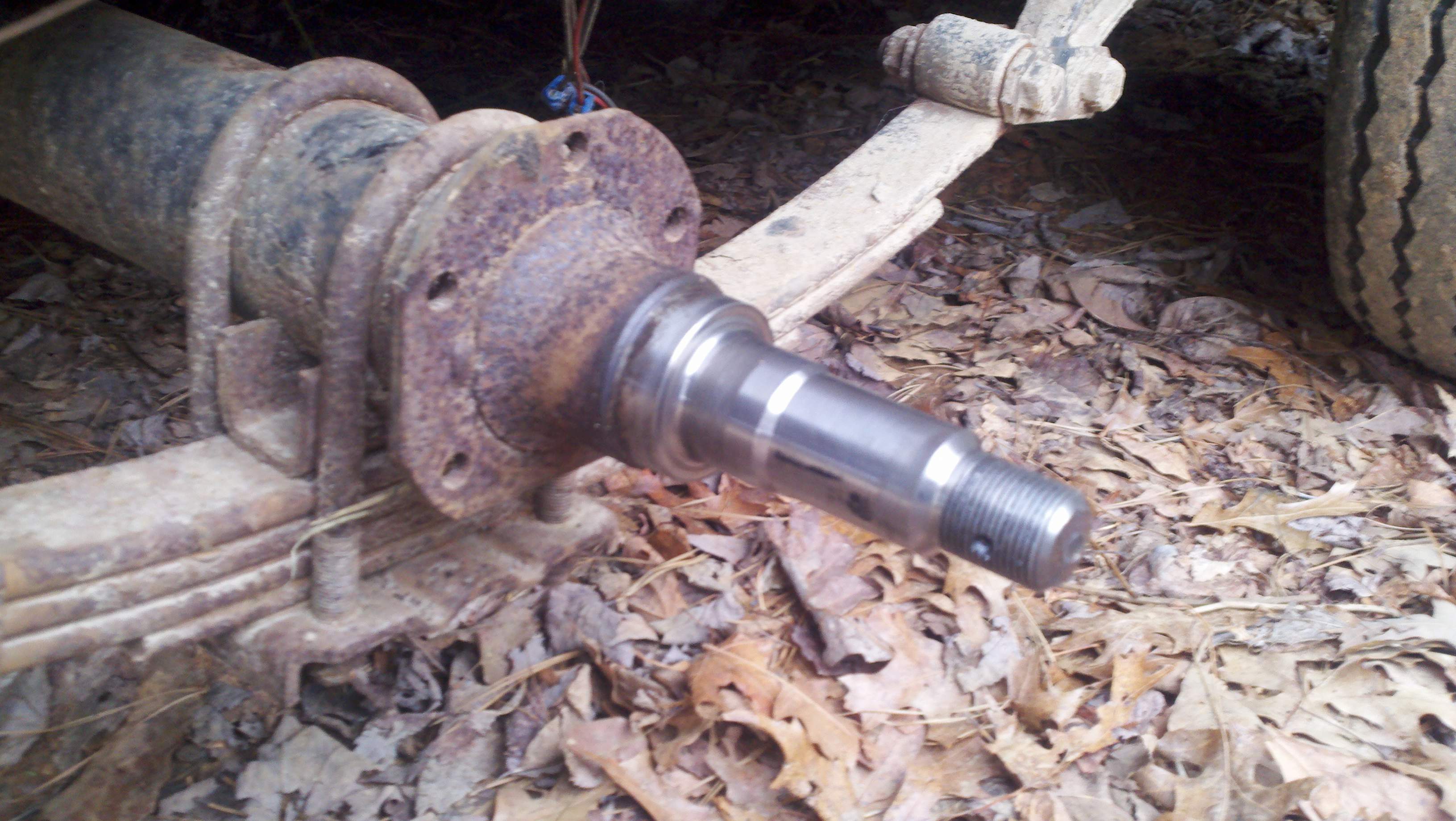

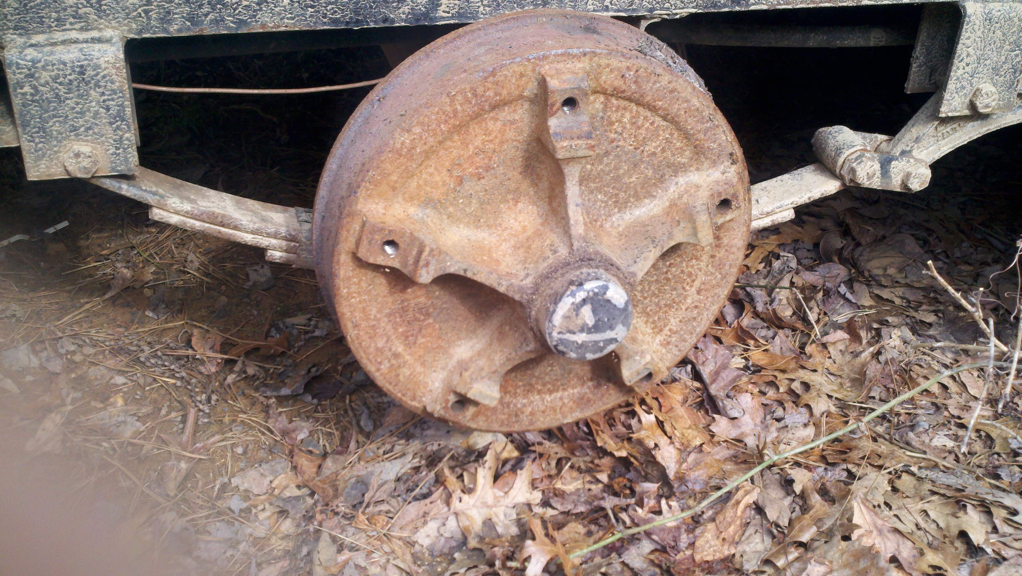

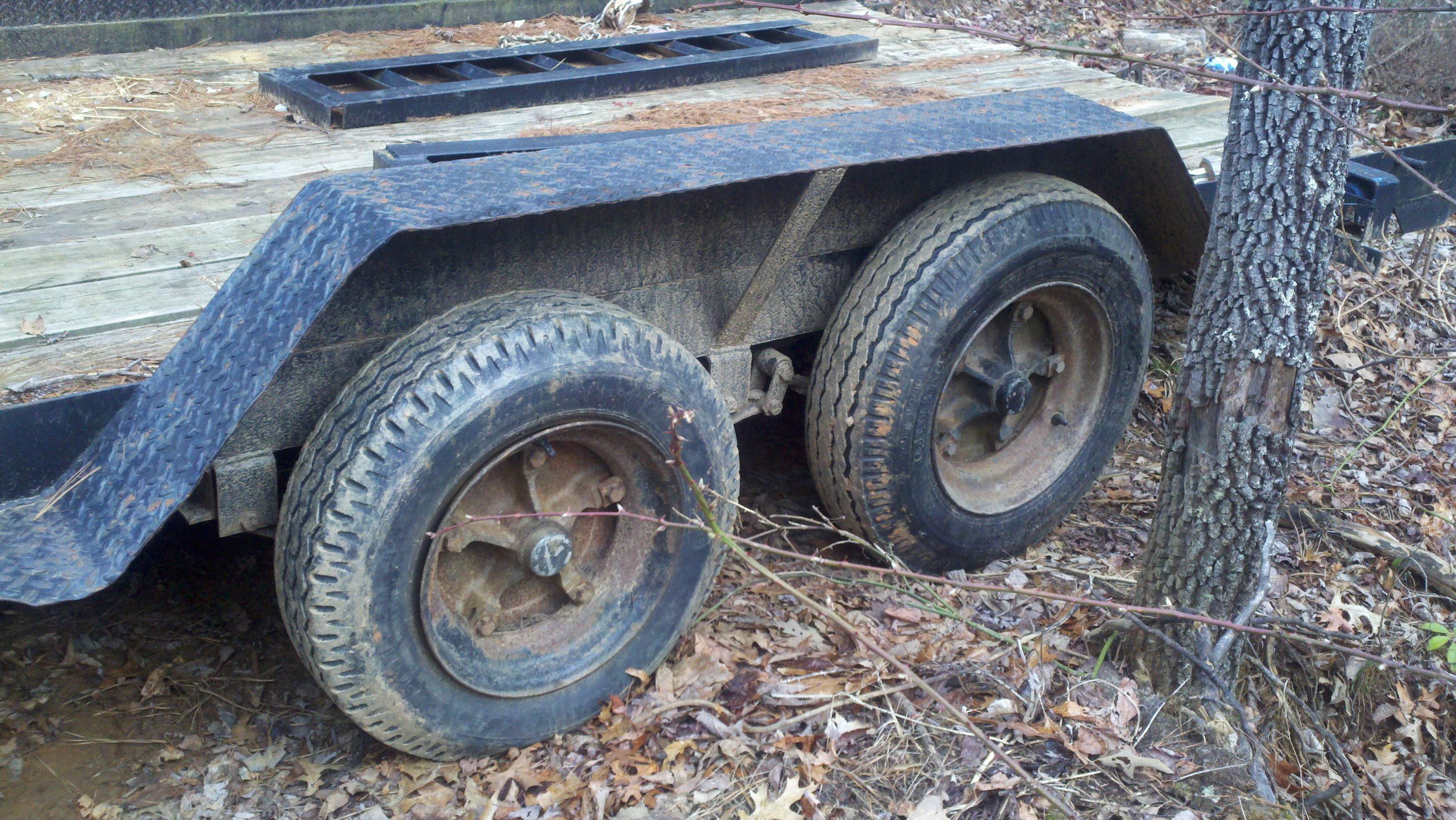

Took the tire off and went ahead and removed the hub. I tooks some pictures and see what you all think. While under the trailer, I found that the axles are made by Dexter. Everything looks factory except the doughnut hub/rim setup. I also mic the spindles and they are setup for HD use.

Those are not MH axles but close.
You can convert them easily to modern hub and wheel setup. I would spend the money and get away from the Pain in the Arse wheels you have.

Started pricing the parts. A little under $1,000.00 so far. Those were Dexter hubs on the trailer.

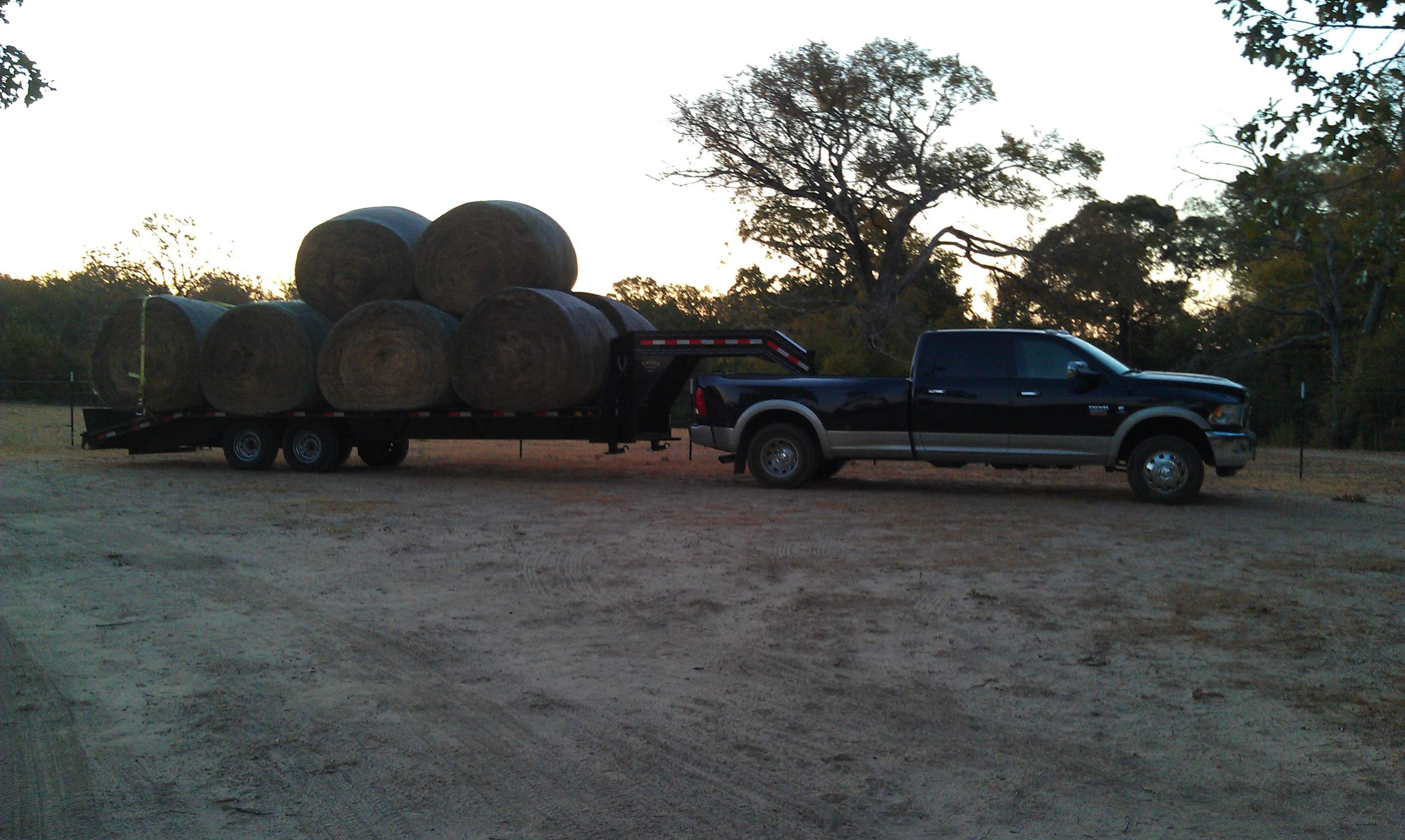

My 2cents would be to sell it and start over,just dont see you(or should say I wouldnt be) pulling that 10,000lb kubota on it..Sorry:D I would suggest a 14k trailergooseneck trailer.jpg (I suggest the lowboy cause I know what its like walking the Hoe up the regular deck trailers)but I know some dont like the GN(I think they are great when hauling heavy loads),so a bumper pull in equal size,if you got the truck for it...
Even at 10k you are close to the top max load,this is mine with 10-1500lb bales on it(yes im over-loaded:D)hayhauling pics.jpg

Everything is factory. Look at the Dexter site. They still sell all the parts or you can swap to new hub/drums.
Dexter Axle - Trailer Axles and Running Gear Components - Hub Kits 5.2K-6K
