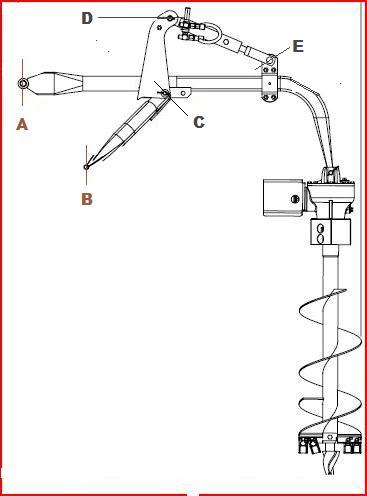

I'm having problems visualizing how this works.
Given:
Point "A" is where the top link normally attaches to the tractor and is strictly a pivot point.
Point "B" is where the drawbar(s) attach to PHD and can be raised buy hydraulics and is gravity down, also a pivot point.
Between points "D" & "E" is a hydraulic actuator.
Which leaves point "C". Is this a pivot point?
So how is hydraulily increasing the distance between "D" & "E" going to push the auger down? I'm not getting it:confused:

The force at point C is going to pull the tractor up by the 2 lifting arms of the 3ph. Gravity rests that weight of the tractor on the auger. Make a fist, lay your arm on a table palm down. Rotate your wrist so that the weight rolls over onto your knuckles. Your wrist is Point C, pulling your arm up off the ground.
Gearmore also has a downpressure kit. Go to:
Gearmore Products
Click on "Diggers and Augers". Open the PDF, and see the note on p. 2 re downpressure kits.

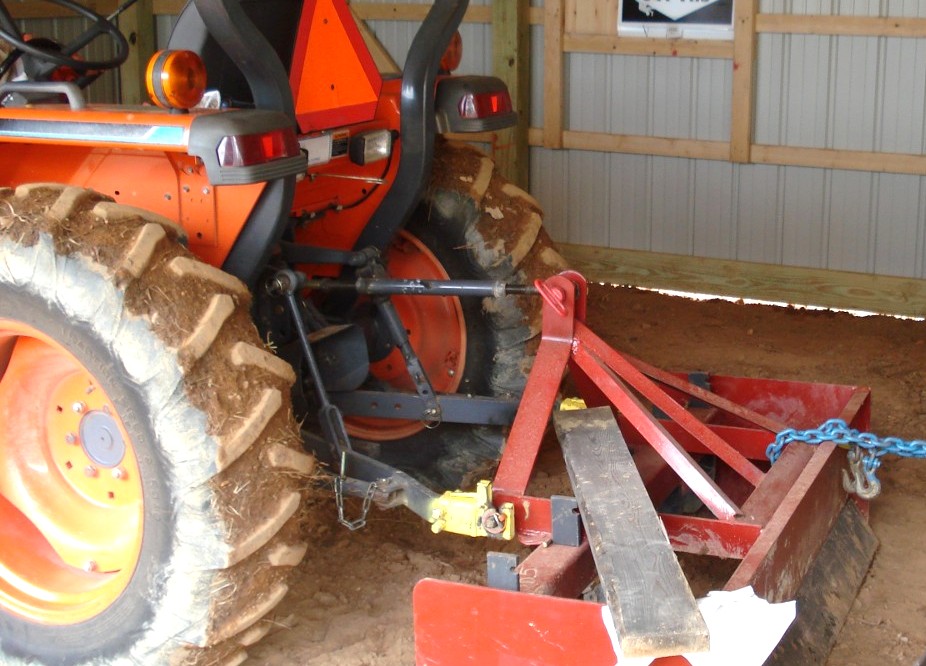

Thanks for the good advice. Here is a photo of my scraper. (sorry for the 2X8) I DID have TWO extra upper attachment bars added for extra strength. Would welding heavy plates to the sides and back ADD RISK for a potential breakup? WHERE could I add weight without risking failure?:confused: Thanks
