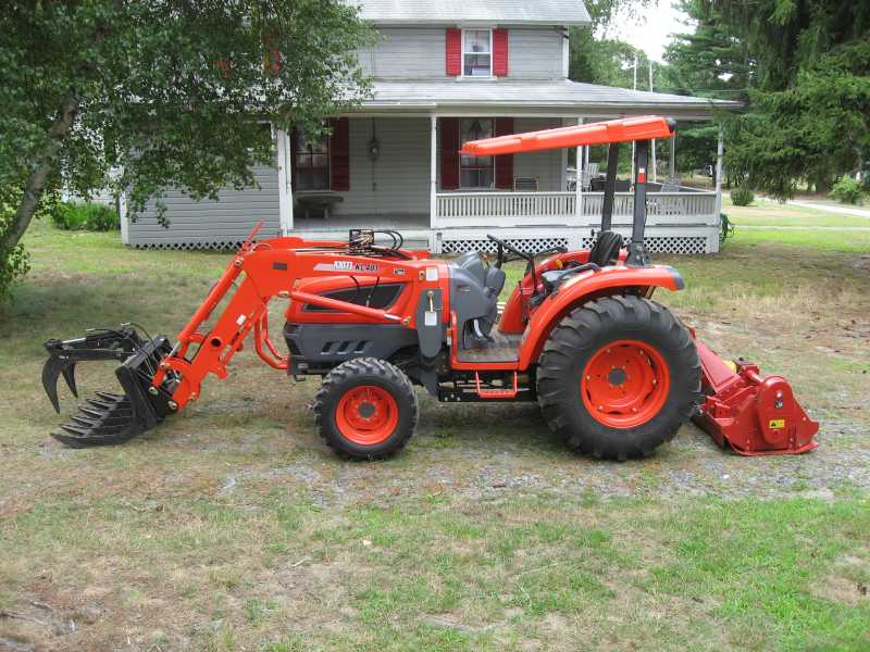

Don't bother with local flails. They will all be US made and start at 4K or so. Unfortunately the US flail manufacturers only seem to make heavy duty models that are rock solid but way too expensive for personal use. Check out AgriSupply and the Italian made Caroni flails they carry. They seem to be the largest dealer/importer though I believe there are some independent dealers who carry Caroni as well. Caroni is a fine company that I think is roughly equivalent to Woods, Landpride etc. $2K would get you a TM1900 (75 inch cut) including shipping and I'm sure the six foot (TL1500) would be less. TM is what you will read about mostly on TBN and it is the "bush hog/finish" mower set up. The TL is more of a finish mower.
Here is what a TM looks like projecting from the back on a 40hp tractor:
