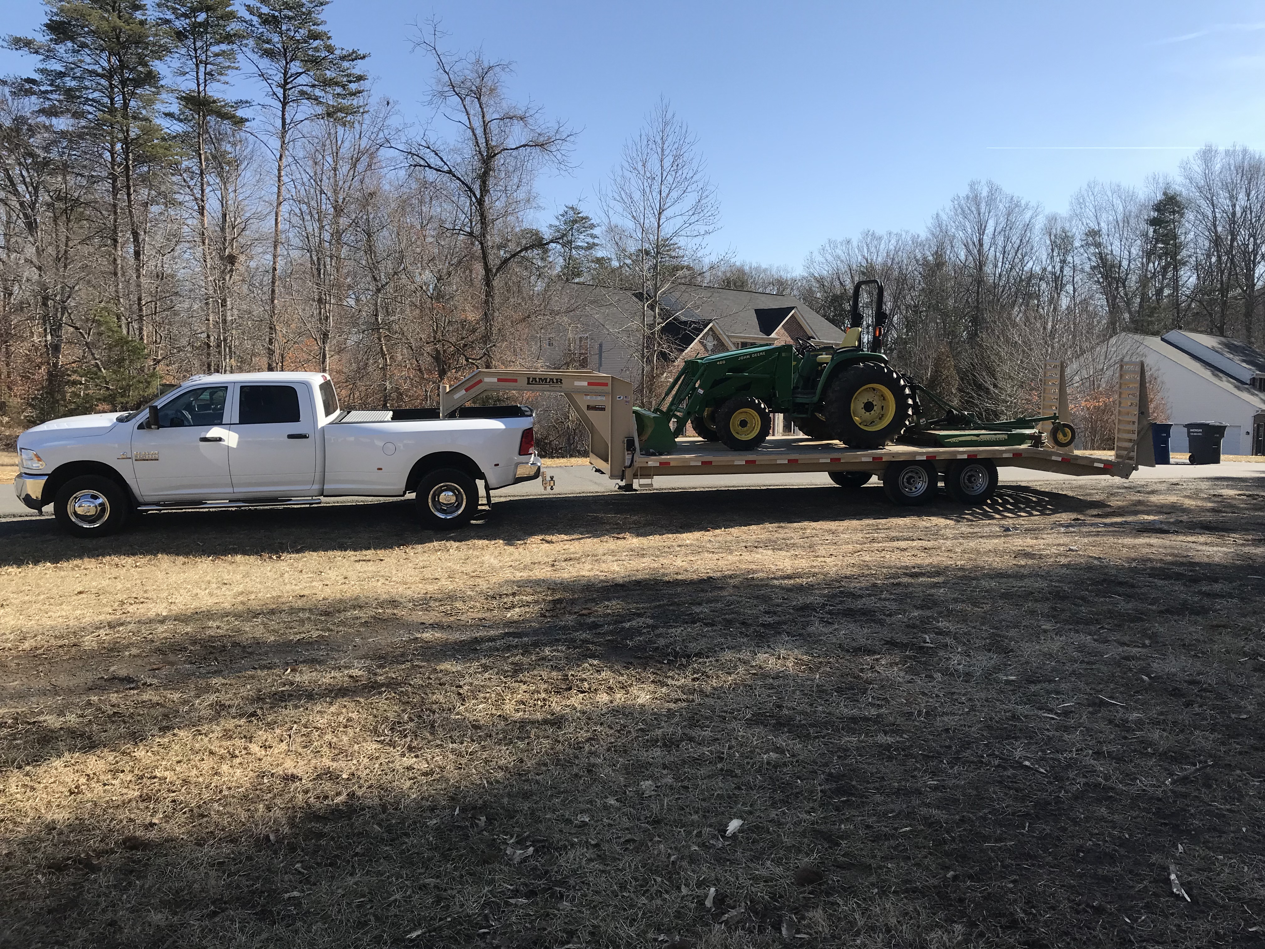

Truck and trailer can handle her no problem.
Sorry for the novel, I am bored and the kids are watching a movie. Haha.
