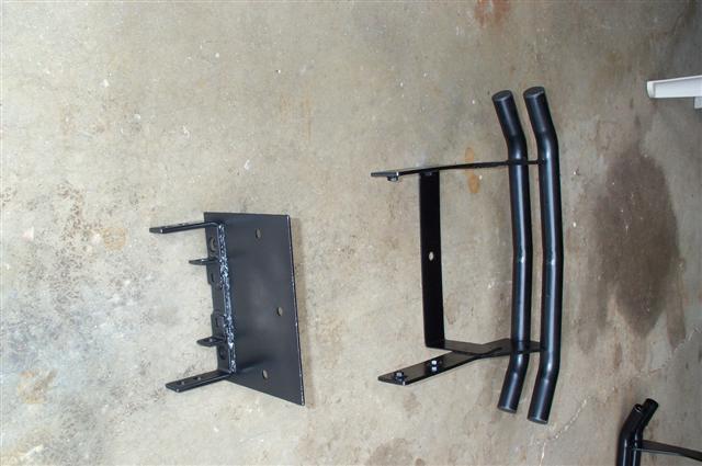

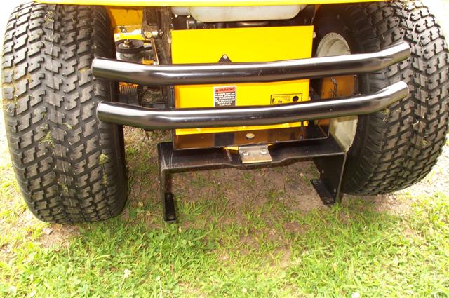

I posted a while ago that i had installed a bumper on the rear. the only mod is to re-drill and tap one set of mounting holes in the bumper. I think the frame holes in the front are something like 1/4 inch different in the front than the back but measure them. What I do remember is that the front holes were slightly different than the back. One set of the Bumper holes were slotted and just make it in the front. That is the center to center holes in the bumper did not match the center to center holes in the frame and would not have worked if the one set of holes were not slotted. The bumper I used in the rear I modified to add support to the rear hitch pin support which is weak on the 2542 and I assume the 1000 series. The 3000 series has a stronger support.
I still have the info on what I did somewhere if you need it, just ask.
charlie in vt
PS-added pictures of rear bumper mod. I tapped the bumper and then welded nuts for extra strength. Looks like I lost the thread on the bumper dimension info but like I said, the dimensions were close but required some modification. Seems like CC should revisit the hole location dimensions and then no mods would be required to use the front bumper in the rear.
