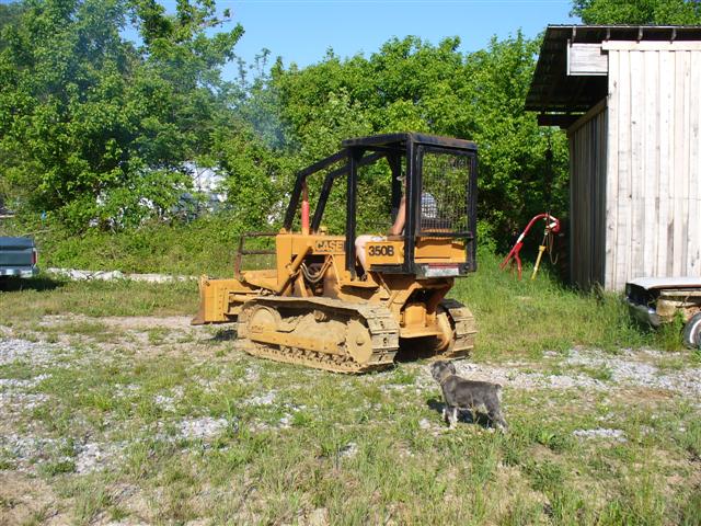

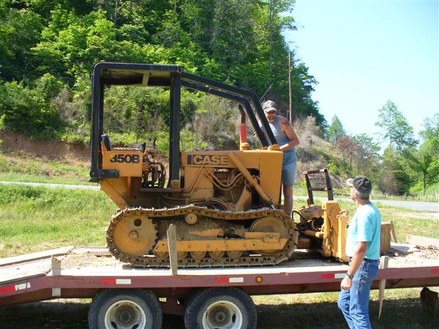

Ok, i did it, i bought a "little" Dozer. I read here all the pro's and cons, and decided to throw the dice on a '76 Case that is in overall good condition. It needs some TLC: missing a few nuts/bolts here and there, the track plates need tightining, complete fliud change, spool valve leaking a bit, throttle linkage needs adjusting. On up side, the tranny is 2 years new, rear end was rebuilt, sprockets and related trac components have very little wear showing, hyrdalic pump was replaced a few years ago, engine starts and runs strong, has a heavy duty ROPS cage. What it is missing are the rock guards....there should be 2 on each trac. I have "googled" myself silly, and haven't come up with a set, so i am hoping that someone here can give me a line on where to look, or should i fabricate some?. I have a lot of limestone rock here, so i think that they will help keep me from throwing a trac off from time to time.
Oh yeah, it hasn't been delivered yet, so the pic's will have to wait.....

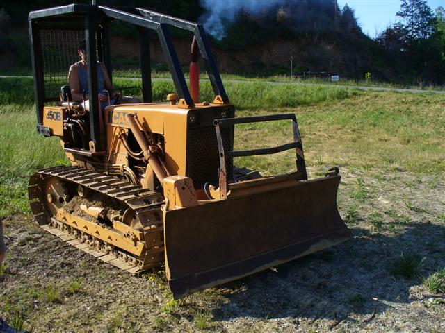

I constructed a set of rock gaurds for a D4 6U, they are not hard to make.
Track frame removal is neccessary and if a pattern from a similar machine can be taken, fabrication will be easier.

   / Dozer: Case 350B rock guards
RW,
What thickness steel did you use? I looked at a set on a Deere 450, and they had a honecomb type pattern. Would flat bar work, or would it be too weak? Any pic's of your fab? Thanks......
RD

Pic's....

I used to work for a CASE dealer (years ago) and if I remember right we couldn't get the rock guards for that 350 or they were way expensive. We had a customer bring one in the get totally redone. The mechanic just made them with 1/2 bar stock, angle iron and flat steel. After he got them painted you couln't tell them from new. At the time even counting his labor it was less than 5 bills total.

MotorSeven said:
RW,
RD
From memory (6years ago), used heavy angle iron and either 5/16 or 3/8 flat
bar, the bolts between the outer & inner gaurds were made from 3/4 round &
the spacers from 3/4 pipe.
