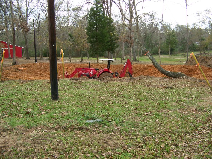

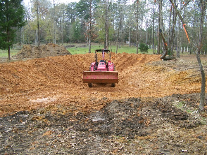

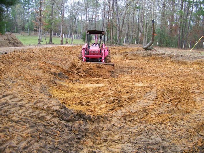

I dug my pond down to 4 feet with my loader bucket. 1-9-09 Mahindra in pond basin.jpg1-2-09 Big RED Beast pushing clay.jpg1-9-09 Mahindra with little turning room.jpg Only limiting factor was the small size of the pond. Below 4 foot, I used the backhoe.

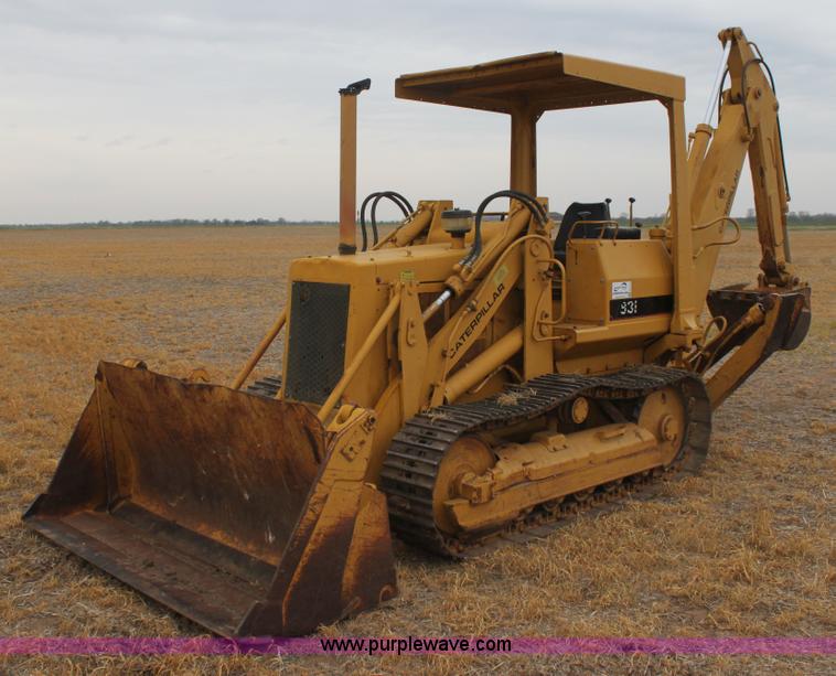

I've been around heavy equipment all of my life, and I've never heard of a "high lift".
BUT the 931 is a "track loader" and from the way you have worded your question, I'd say you are a newb and much better off hiring out the part of your job that you can't do with your tractor.

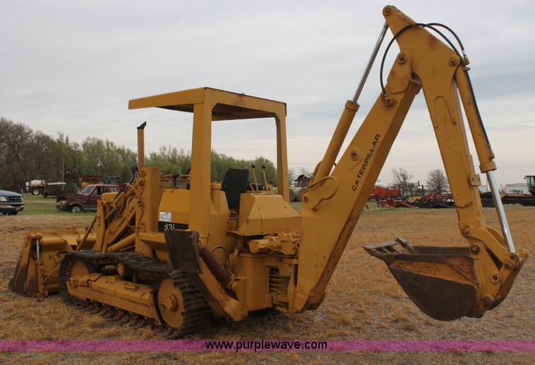

Just did an image search, the 931B track loader had a backhoe option:
