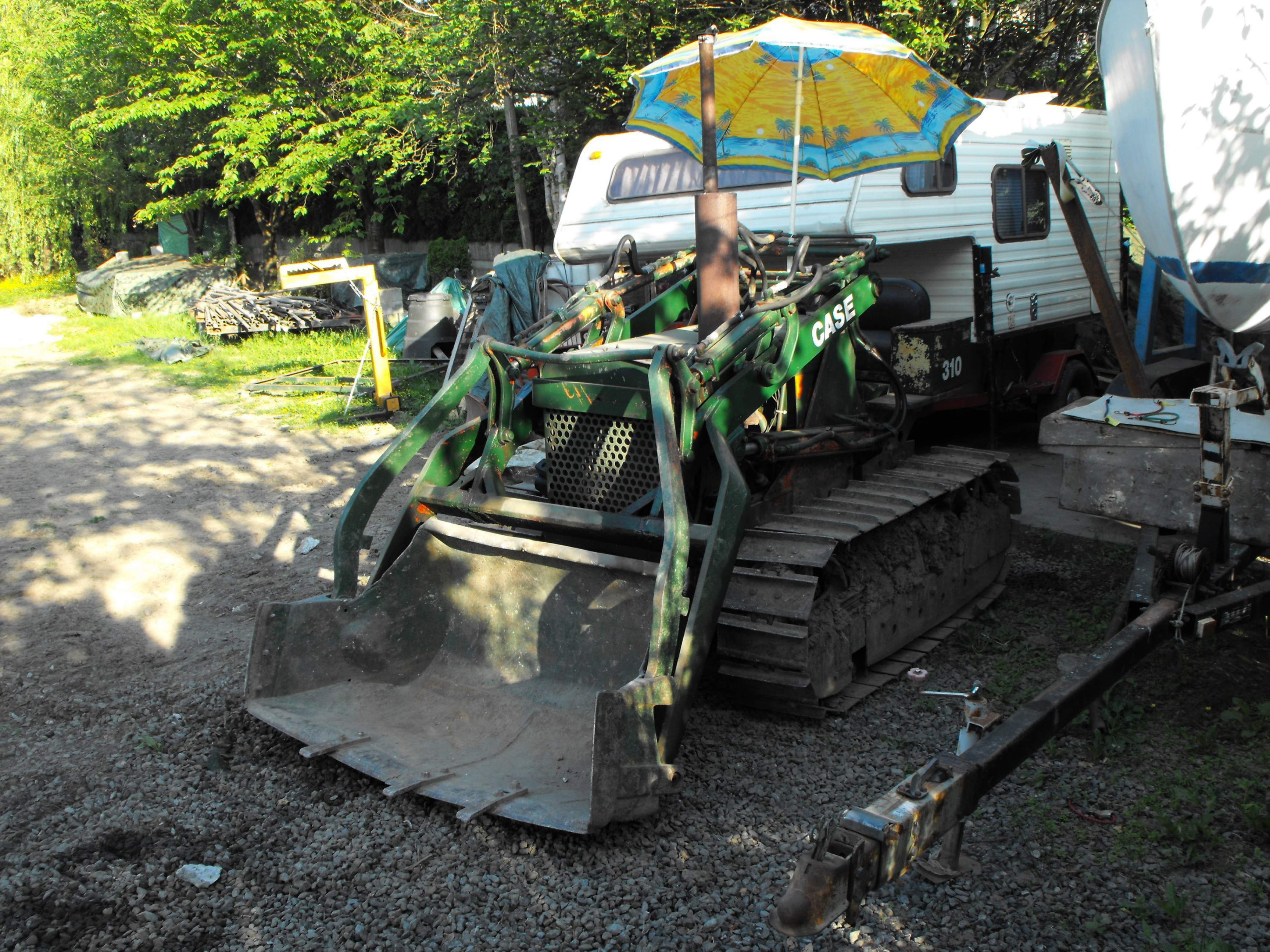

So 310 Guy's have you ever seen a loader bucket like this one?
I pick this up new years weekend - I did some horse trading with a fellow I've had dealings with before.
He hasn't had this for long and has no info on it - so I thought I'd ask here!
This is a 4 cyl.gasoline, 40 h.p. ,3 spd forward -1 revsre.
1953 to 1956 310 crawler.
That's what he tells me ,he got from the guy he got it from.
So I'll leave it to you guys (and gals) to help me out!
(Sorry, it's so big it was the only way I could get it to work and I'm not good with computers much.)
I'm not sure if the bottom of that bucket is supposed to be like that or if it's bent ,it doesn't lookstriaght from my point of view and the bars bolted into the bucket is the doing of the guy I'm getting it from .
Any one know what a normal bucket is worth?
Or I may weld up my own ?

I would have to double check in my shop manual, but it looks like the factory Case loader of that time.
   / Dozer vs. Tractor #24
I would say the buckets look about the same. This is the one I just picked up on saturday. Actually my trailer was too icy so it got clanked up the side of the road. Took forever, ended up blowing the water pump and I had to drag it with the Zetor. Turns out its a 420 rather than a 310, but basically that's the same machine. Ordered an alternator and a water pump from Crawler Heaven out in NY, that guy seems to really know his machines.

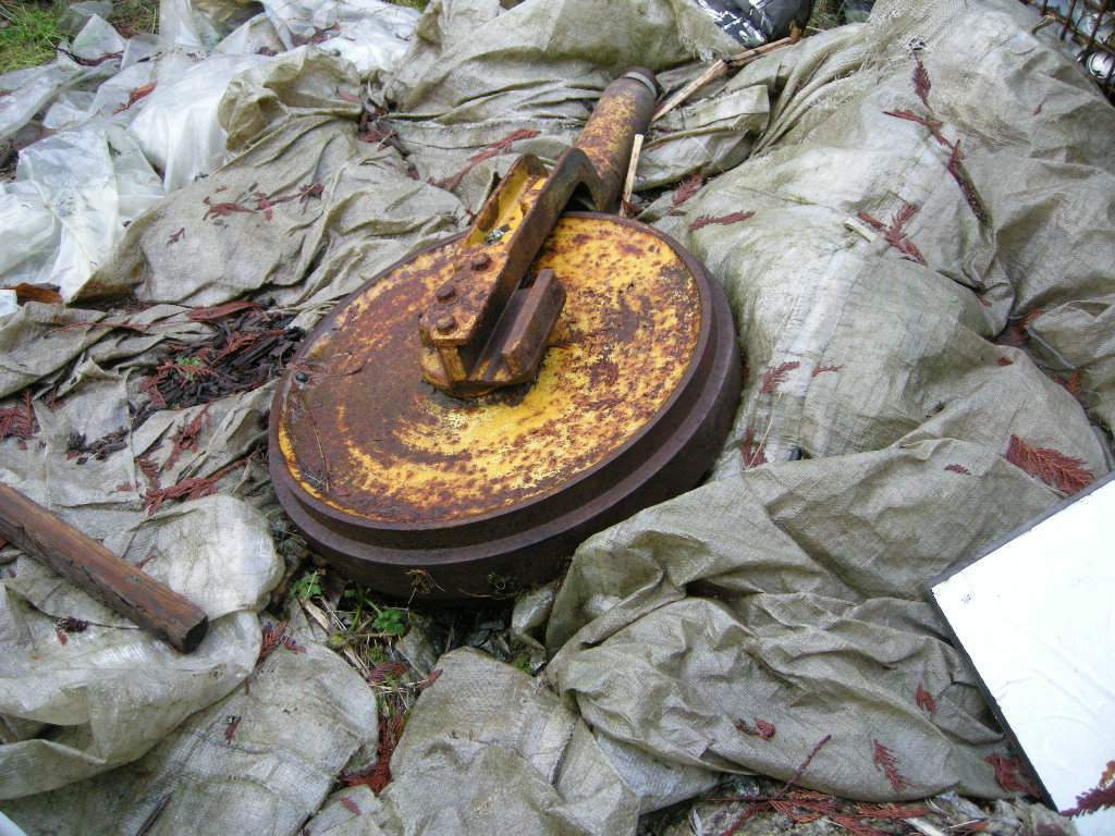

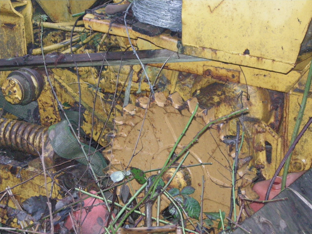

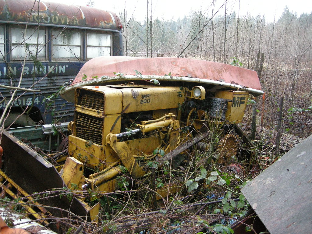

I went back to looking and found a Massey Ferguson 200 with new undercarrage (but it needs to be installed) and a 6 way power blade.
Estate sale ,bought it delivered to my shop as is for 1900.00cnd.
I'm figuring the sporckets and chain gotta be worth that.
It hasn't been run is 1 1/2 yrs,has had the boat sitting on top all that time.
The father bought it with about 200 hrs on it no idea what's on it now.
He cleared a 40 acre. plot and a 24 acre plot and then it was just used for clearing snow and draging things around. The exhaust was removed when the machine got parked where it is to replace the chains and sprockets as it was rotten, the Dad passed away at this stag and no one wants to touch it.

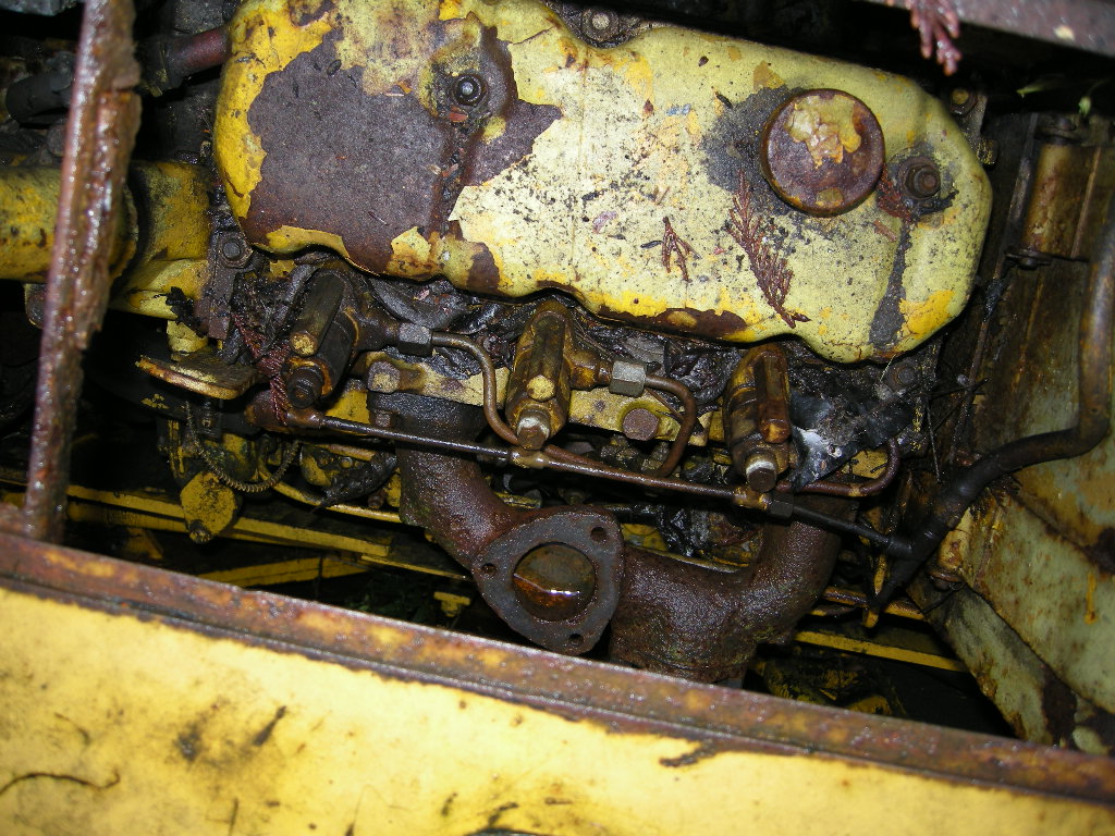

There is water in the exhaust manifold as seen in the picture but the boat got moved when the first guy came to lookand it's been raining hard here right now - or it's been wet for a long time.
Rebuild kits look pretty cheap at $600.00, I think I read somewhere it's about a 30hr job to rebuild a ab3.152 perkins ,I'll $30.00 an hour to get that done and I'll have a new motor for $1500.00 and a nice little machine for under $5 grand.
Anyone have any knowledge of the MF 200 Manuels etc

Nice looking machine, to bad about the motor. It kills me to see equipment without a muffler sitting around. So did you get a boat and some barbed wire tossed in the deal as well?
   / Dozer vs. Tractor #27
I have that same engine in a MF 30 TLB . MF sure loved that Perkins 3.152.
I have gotten parts at a couple of places, the last was a MF farm tractor dealer.
He said he could get parts for any MF ever made.
I have read that MF has their parts system on line and you just have to get a dealer to set you up for access.
Have not tried myself. Mabie Brothers in Syracuse NY was recommended to me by a guy who works on Perkins engines all the time.
