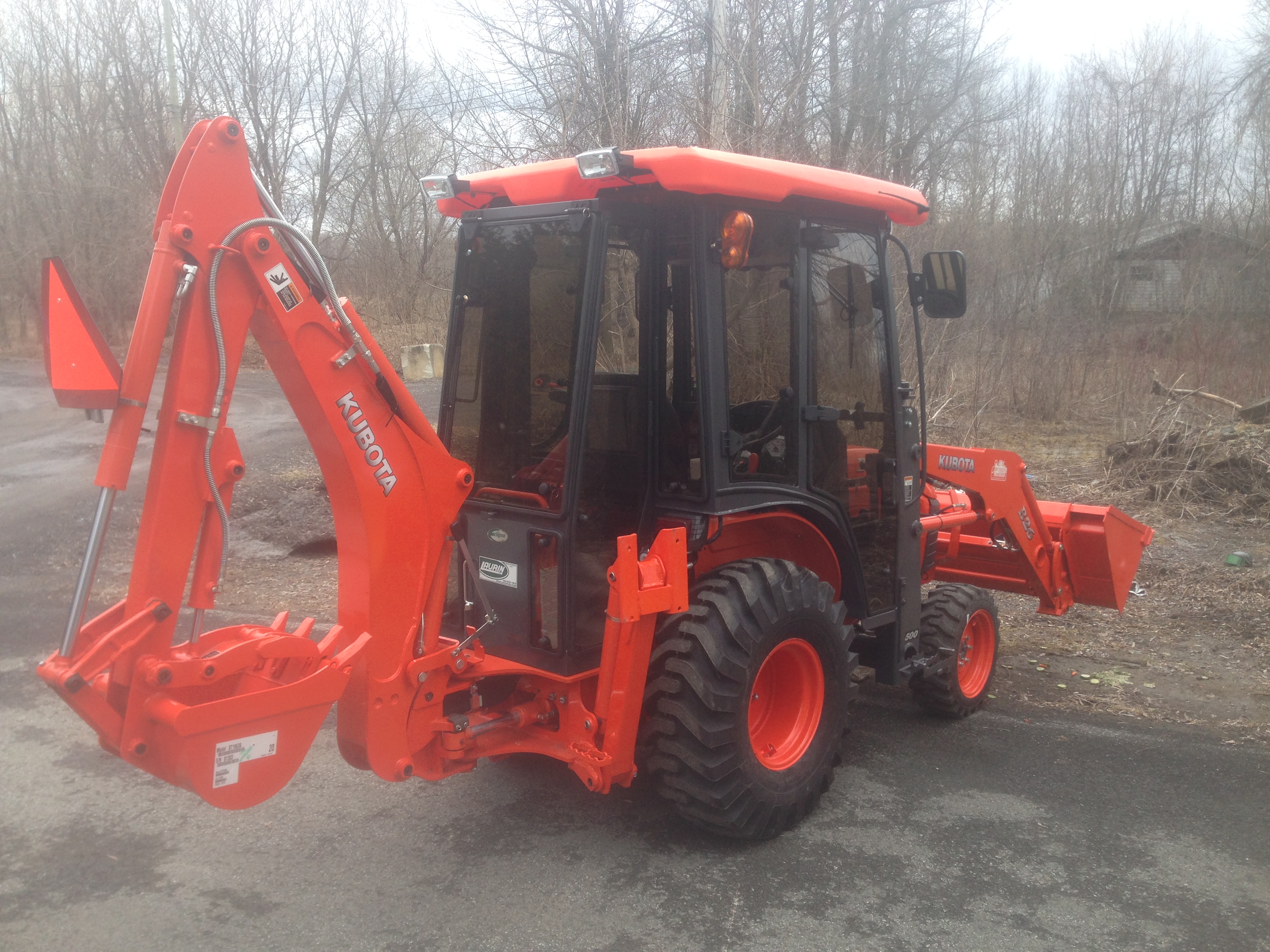

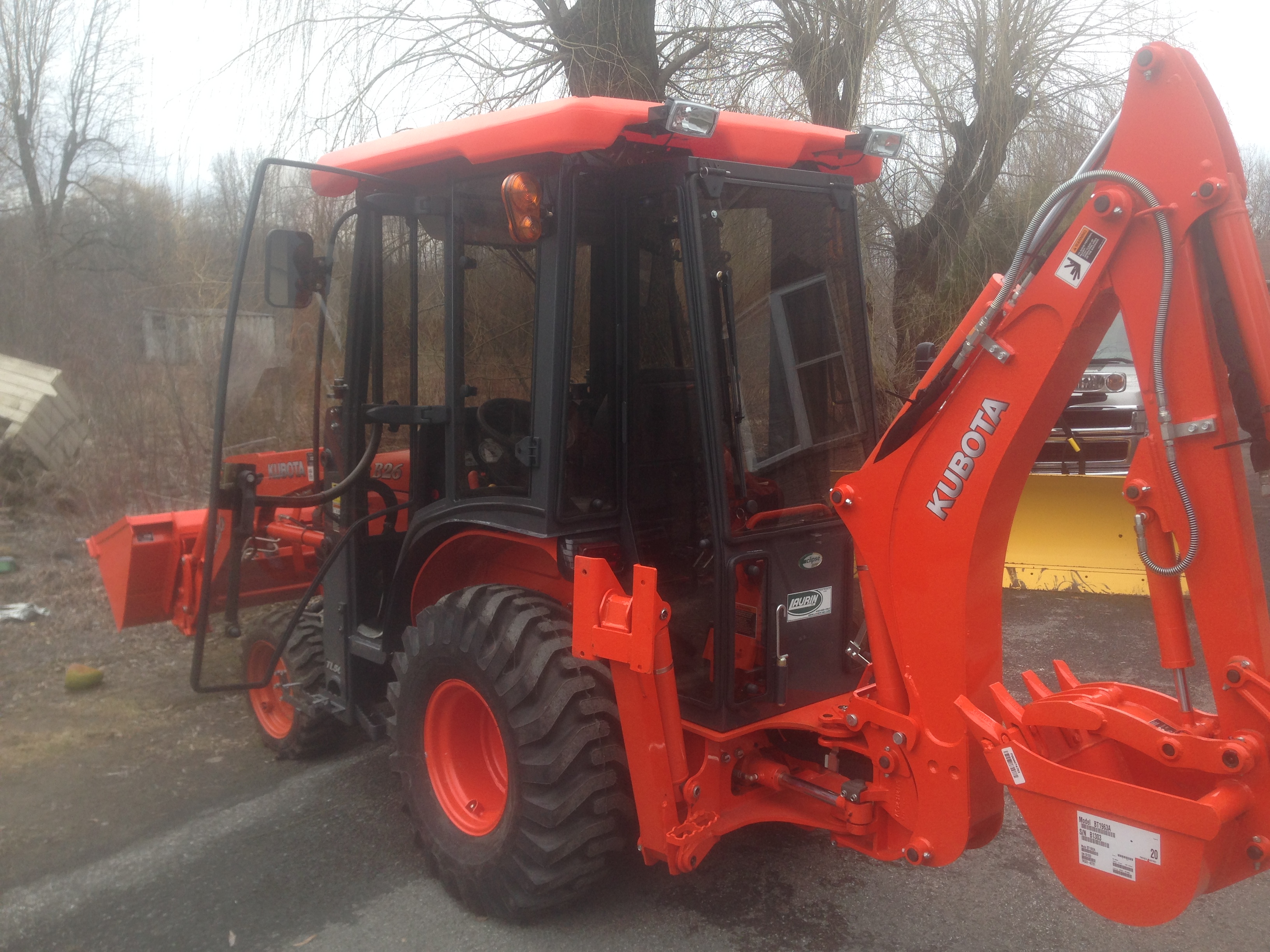

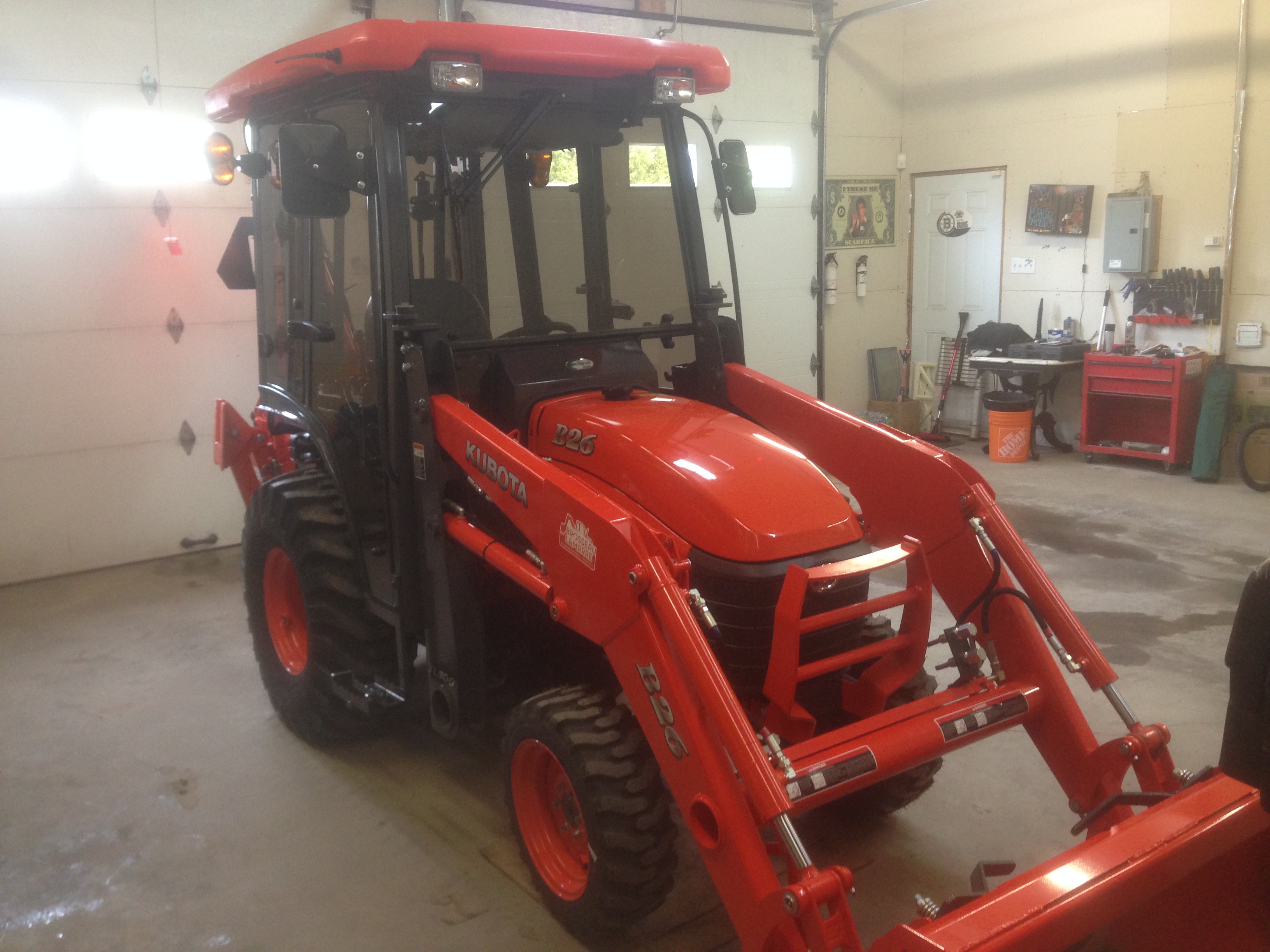

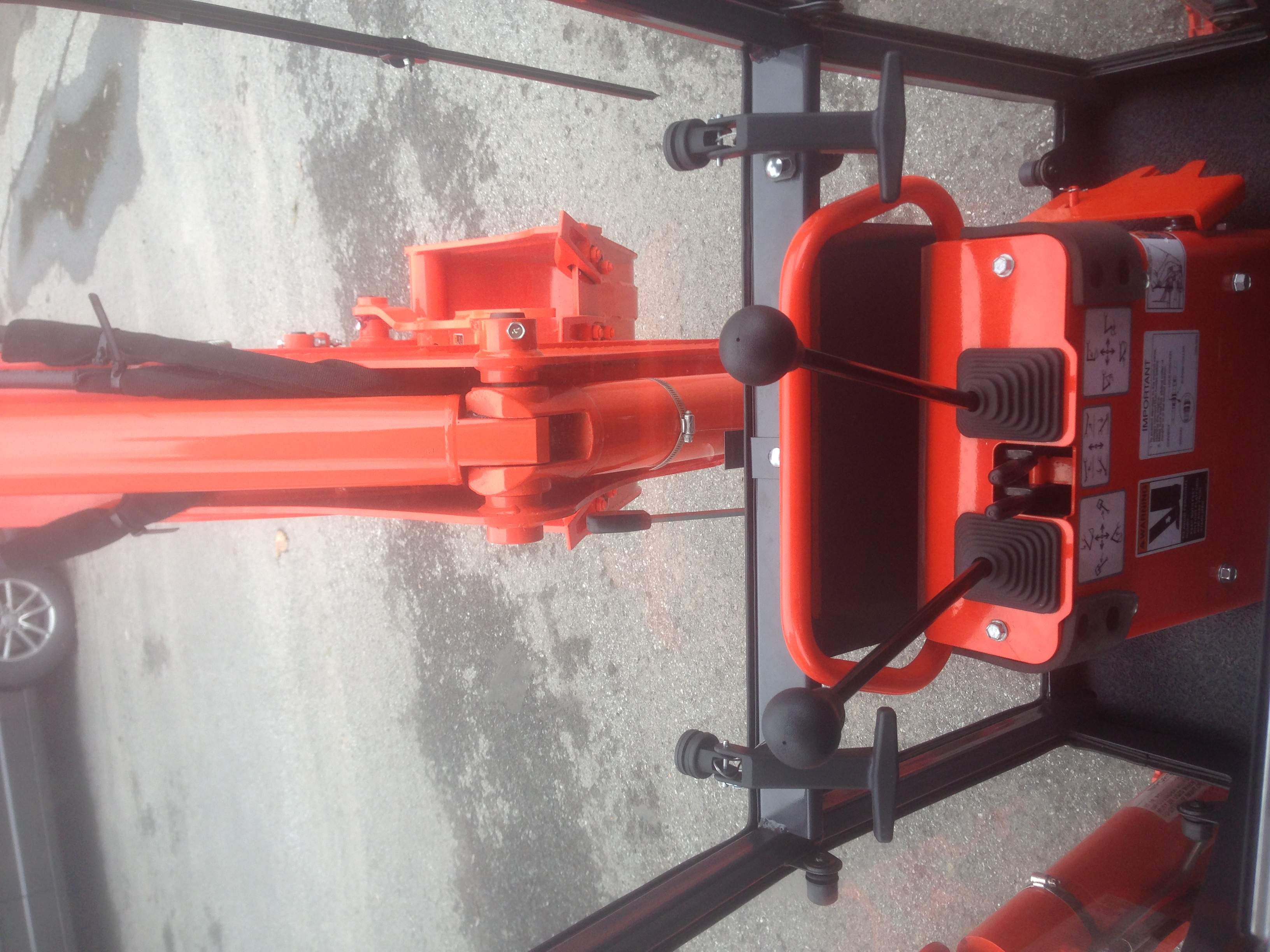

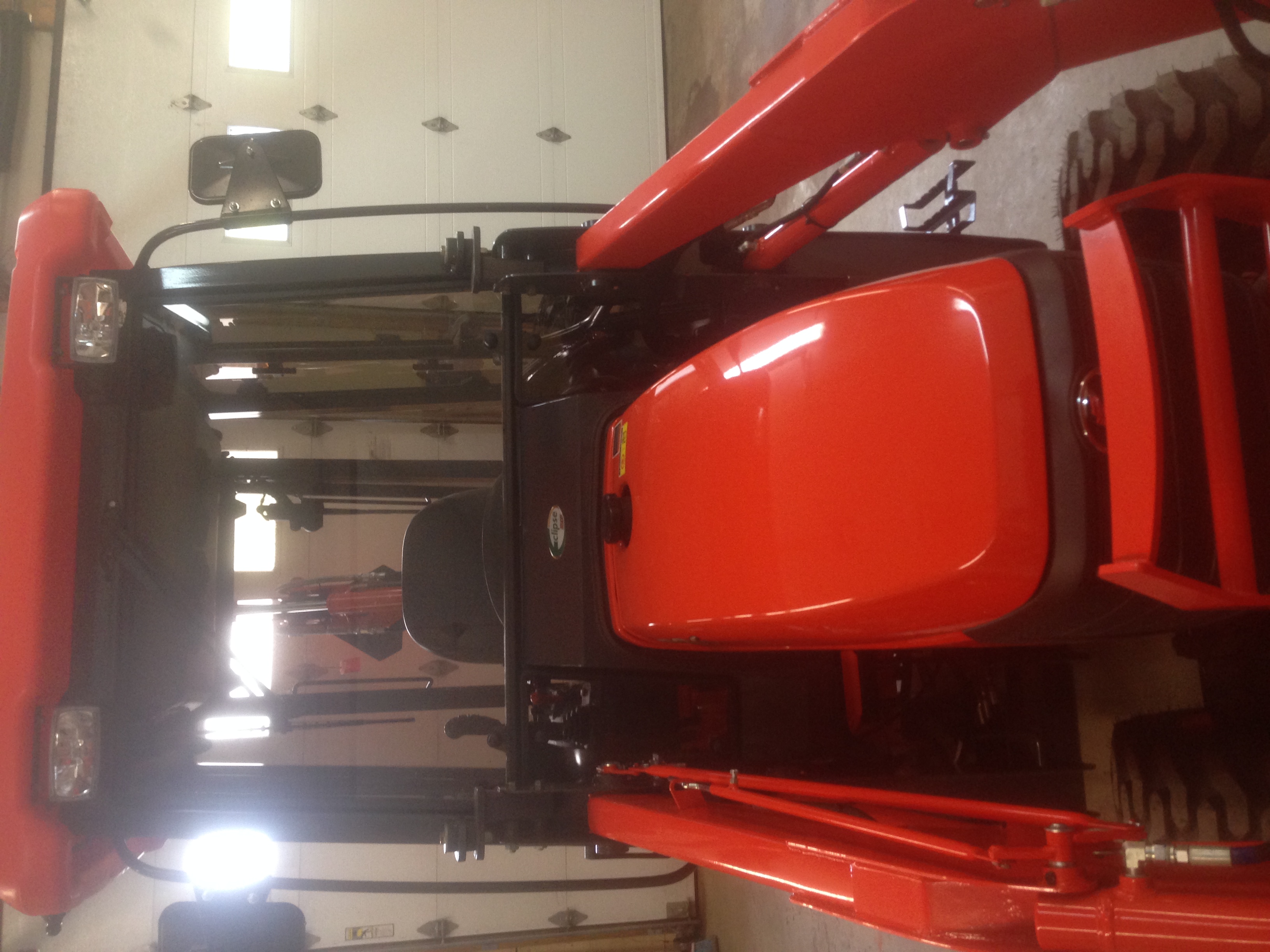

Well here's the new,2017 b26 with a laurin cab..it is very nice,heat/wipers front&back/radio..it is a little tight inside.glad I'm still flexible at my age...side windows open,so does rear..for cooling off in summer..rear window detaches and reattaches when you remove BH..so bring on the snow..I can't wait for next winter..I have the 64" rear kubota blower...with hydraulic shoots..also.3thrd function valve...so I think I'm ready.
