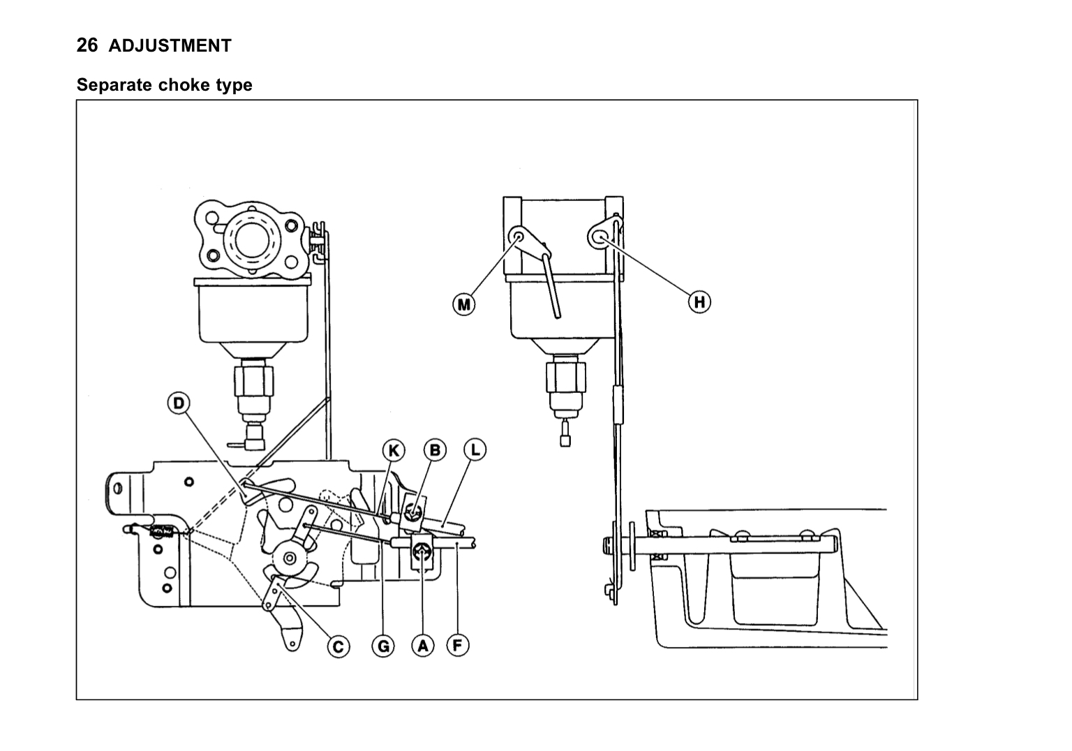

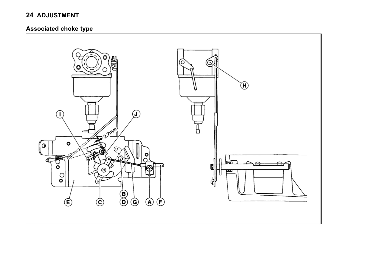

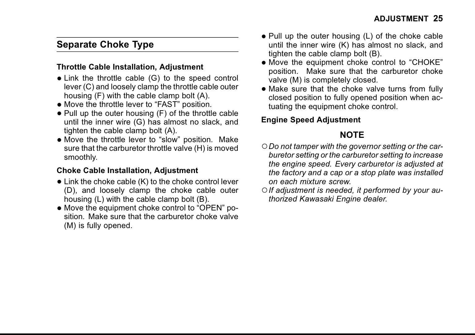

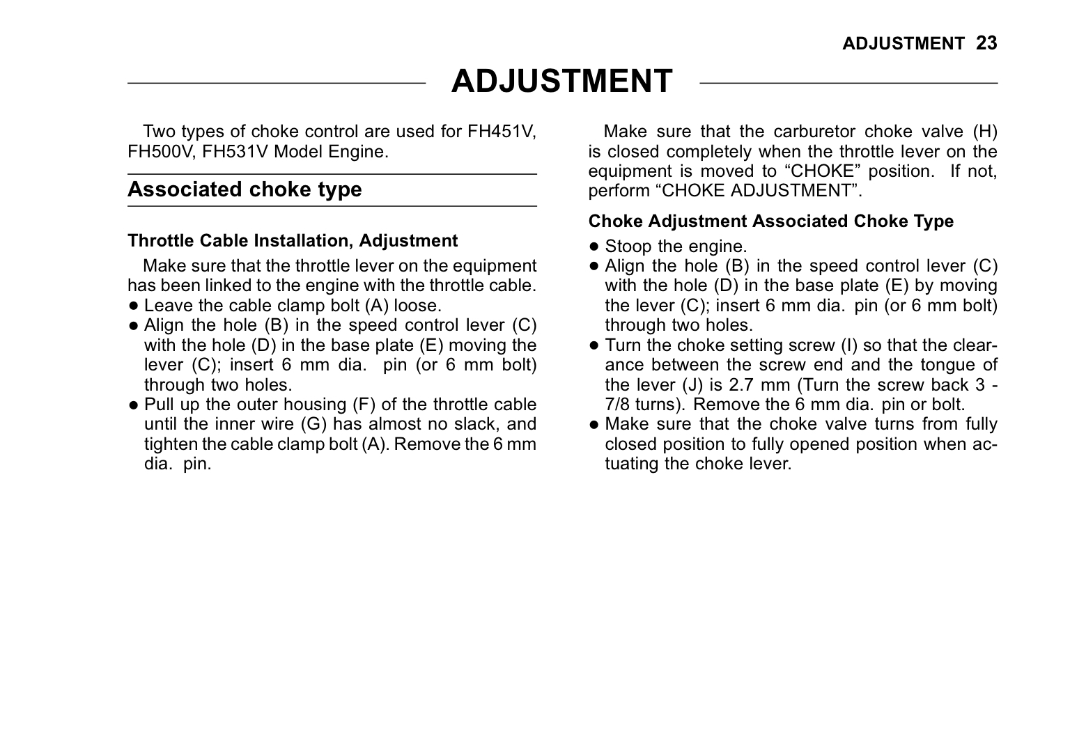

Dr brush mower
I have a DR Brushmower that runs at a slow idle when fully choked, dies when I move to run. It’s a 15hp Kawasaki engine. If I fiddle with the throttle at the carb, I can get it to run at speed. There seems to be some feedback that is shutting down the engine.
Does anyone have a shop manual with the carb details. It’s a mikuni carb. The mower is a 2001 or so. I have an operating manual. It has no carb details.
I suspect a spring or control rod came loose. I don’t know these well enough to figure it out.
/ DR Brush mower carb setup #2
I have a manual that describes the carb adjustments for a Kawasaki FH451V 15hp engine if that's what your engine is. My engine may be a little newer though... around 2002-2003.
It's a very basic one page thing for what they call "associated choke" or "separate choke".

Here are the relevant pages :

Thank for the pages!
