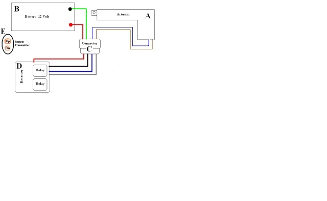

My DR grader took a hit to the connector and relay box. I have the new relay box, but need to know what wire go to what. They are different colors on either side of the connector.
Could someone with a DR with the remote take a look and post wire to wire colors over the connector?
Thanks
   / DR Power Grader Wiring #2
Here you go.
Thanks, but that WD is for the hardwired switch version. I need the one for the remote control version. It operates from two independent relays, not a DP/DT switch, wiring is different.
I tried looking for one with the remote and non of the pubs by DR seem to have that WD. Searched my fingers off trying to find one, no joy.
