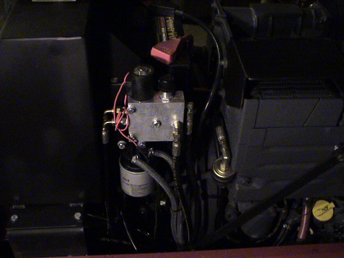

anyway, I took a bunch of pictures of thingy's and dingus that I didn't know what they were
I have attatched a picture of my 1430's draft control dingus
do I just turn the black knob on the right by hand until my mower is sufficiently raised?

That is how I do it. Set it at high idle. I think you pull up on the nob to turn it... Also as I remember there was something about having ot have the brakes off (on my tractor).....
Carl
/ Draft Control #13
Brakes on please! We want to keep you on TBN.
You don't need power to the wheels, just enough above idle to get a decent response.
There is a lock ring on my draft control. Following Mike's instructions worked for me.
