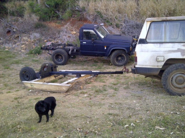

Dragalong is almost 7' wide. It sure has done a good job in all its incarnations. It started off with just a chain bridle hooked to the towball (needed too much room to turn around but when you got stuck you could reverse up and do a running snatch to get it out) - then it got the teeth on the front - then it got the towing arm so it could be reversed (sort of - on flat smooth ground at least) - and now it's finally getting up/down wheels so it's going to be a pleasure to use now. Maybe a few cutouts in the front I beam will allow some more material thru to the "box" and I have thought about some method of "ramping" the rocks up into that box too so that they can all be dumped in one location.
Another incarnation maybe it turning into a towable scraper that can also be driven from a diesel motor & box & shortened diff (with dualies) out back and the motor can provided hydraulics and all the controls that need to run up front will be for clutch, throttle and the bucket hydraulics - I have been known to think up some crazy :confused2: stuff but I reckon if I win the time lotto, it could happen. Just a bit tidier shifting dirt over a distance.

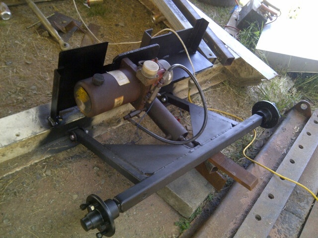

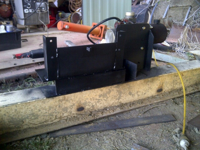

Will try to get the battery mounted up tonight for prewire testing and I have changed the plumbing on the ram so it will work the right way - I took it off a tail lifter I had lying around

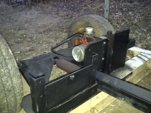

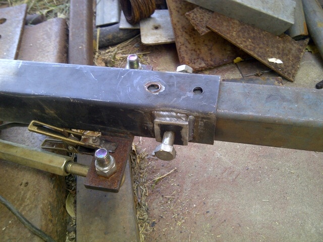

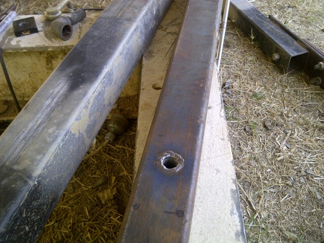

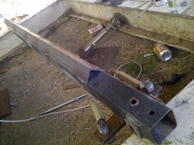

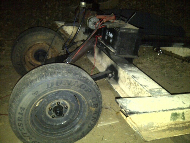

Some more progress during a week of hottest ever September on record - why do I keep all my junk in the shed and work outside in the weather????
More pics anyway of the battery tray and some protection for the pump etc and a bit of reworking of the towbar seeing as it will have to take a little more weight with the wheels in operation.

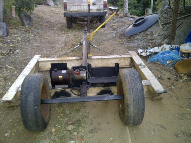

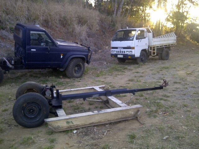

So it looks like something now that it has is wheels on. Now that I have finished welding I have moved it from outside the "welding shed" to park it outside another shed to do the wiring and bolt up a cutting edge underneath.
And I have to work out the rain cover too.

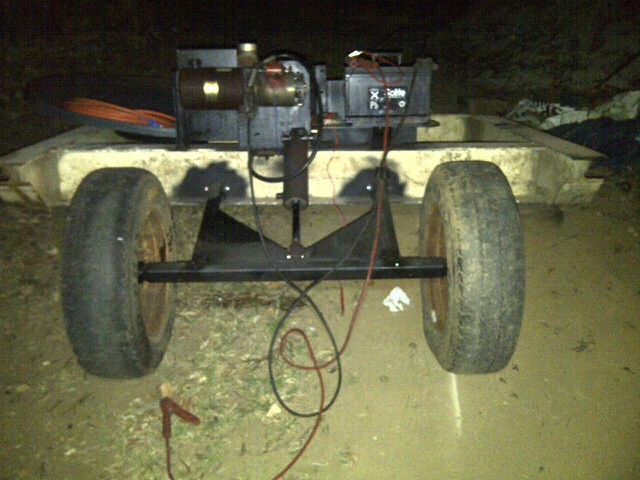

Prewire testing works

looks good. You might want to move the wheels further back. as they are it looks like they won't span much more than the skids would.
I made something similar to what you made, and I would like to move my wheels back some more.
homemade road grader
I like your build Dan - I know what you mean about the wheel positioning - ideally the cutting edge needs to be 1/2 way between your rear driving wheels and the rear wheels on the "land plane" etc. Mine was determined by the length of the ram and the easiest way to position it and taking into account the available material to "swing" the axle on and how strong the material would have to be to "have them way out back". It should be ok in this instance seeing as the the front is a cutting edge too & roughly half the wheel distance
