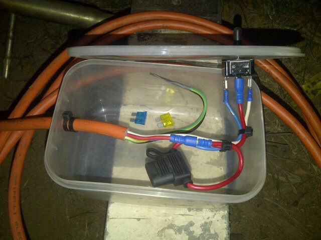

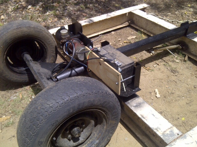

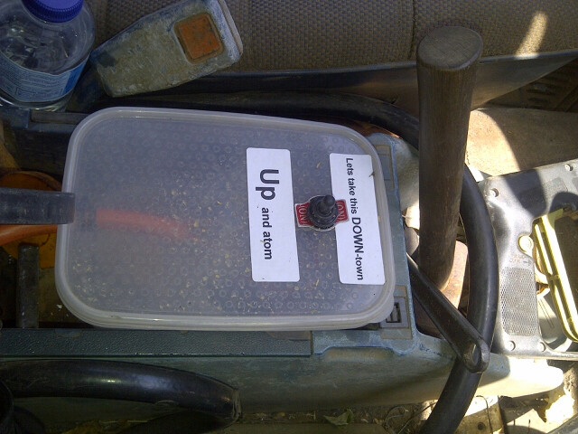

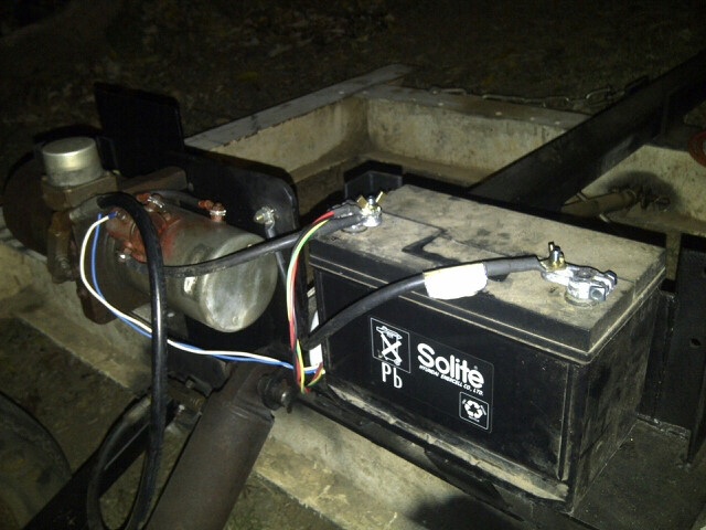

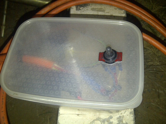

Wow! It works - well up and down at least. All wired up now with a long enough lead to the control box to be able to reach the cab of my dump truck (I might be able to dump and level on the run with a little practise). I left a couple of spare wires to allow for charging from alternator or battery charger or solar panel etc (I could put a propellor on the roof as a wind turbine but that might be getting too crazy now - the speeds I would have to travel could get dangerous! :eek:)
I had to adjust the little flow control valve because it was taking 20-30 seconds to lower - now it seems to take 10 but is probably more like 5 - should be ok to get used to and once the full weight from being on the towball it will be quicker.
Just a few things before it gets a workout this weekend - bolt on a grader cutting edge at back - strap in the battery - a couple of conduit clamps on the cable - cut some big slots with the oxy in the front I beam to allow some material through - and if time allows put a flexible cover over the workings with some conveyer rubber and mayyybe bolt on a chunk of angle at the front to be able to bolt another grader blade that will sit on a 45 angle in front of the mini rippers but it will sit an inch or so higher and will have a series of 5/8" bar spaced every 4" or so on the same 45 degree angle and all this is in order to scoop up rocks into the "box" for dumping at the rock pile - I might have to add "rock picker" to its name. (Might not have time for the rock picker this week though)

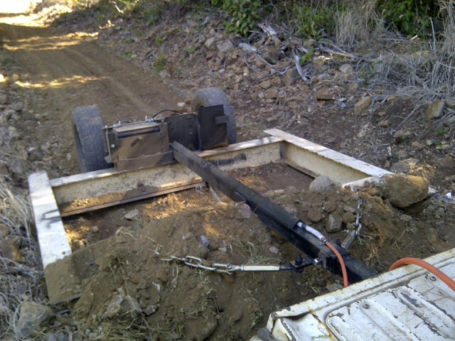

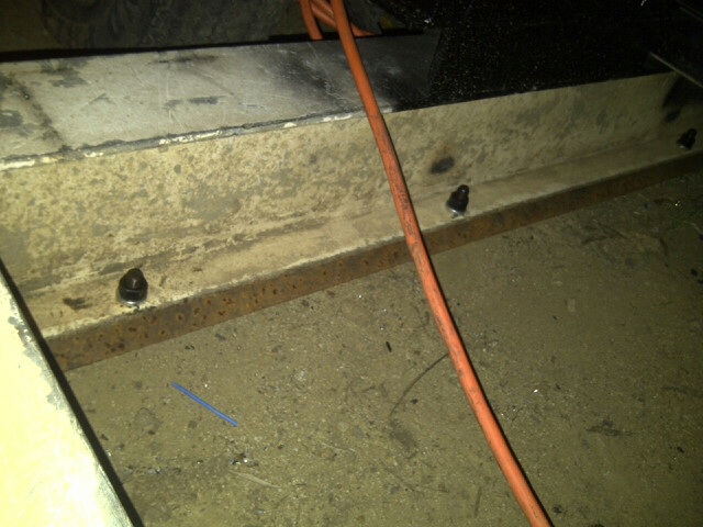

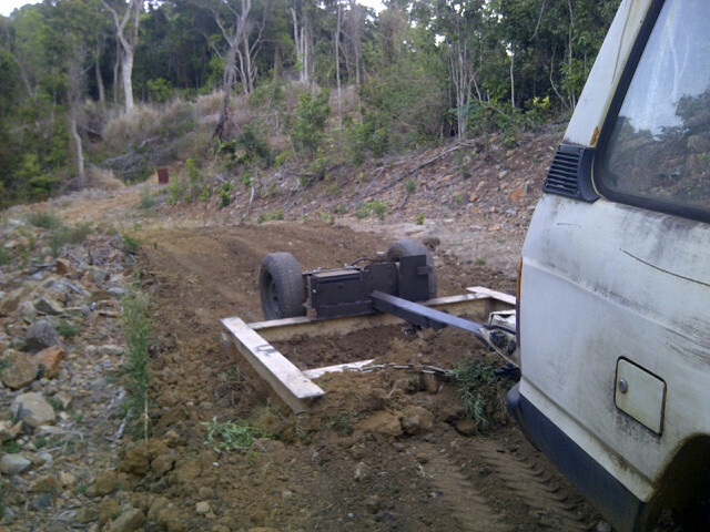

So the big day is here - tests will commence. Still a job or two to finish but it has a cutting edge bolted on to the rear I beam with hopefully enough bolts :confused3:

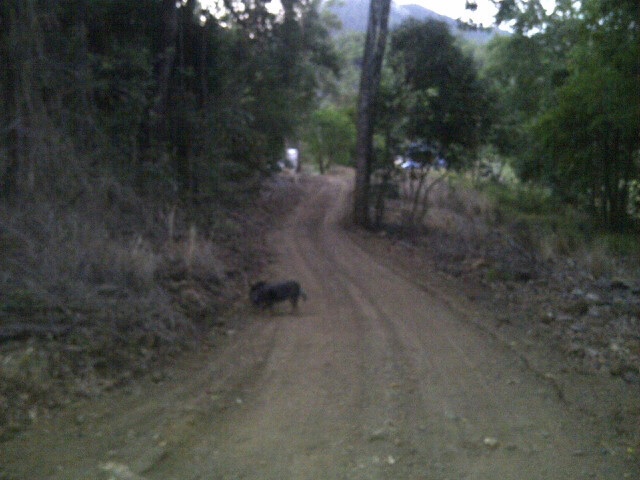

All good so far after day 1. Am gunna have to organise the charging side of things (or put a charger on in between use will do for now) and I think I may extend the swing arms slightly so I can run 8 ply 185 x 14 tyres and still get the back end right down and with a little cutting action. I have also heard that you can get tyres solid filled with rubber so that will add a bit of weight. Nothing broke, so it was a good day.

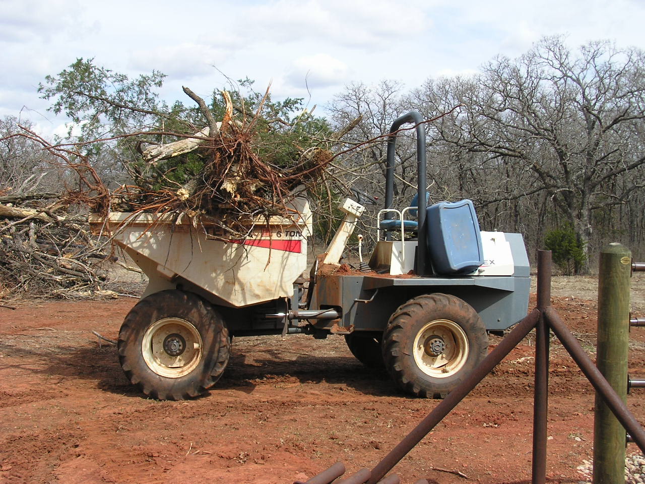

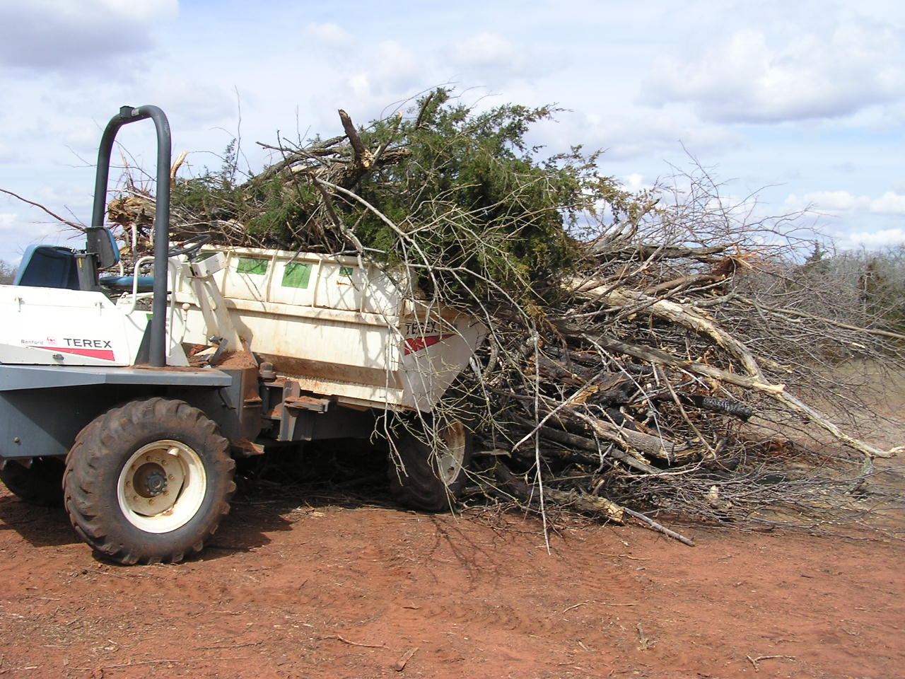

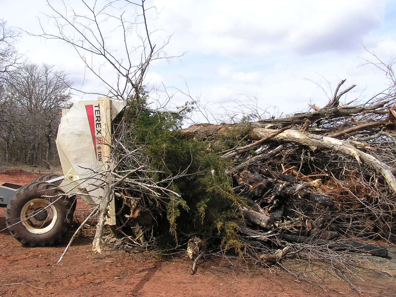

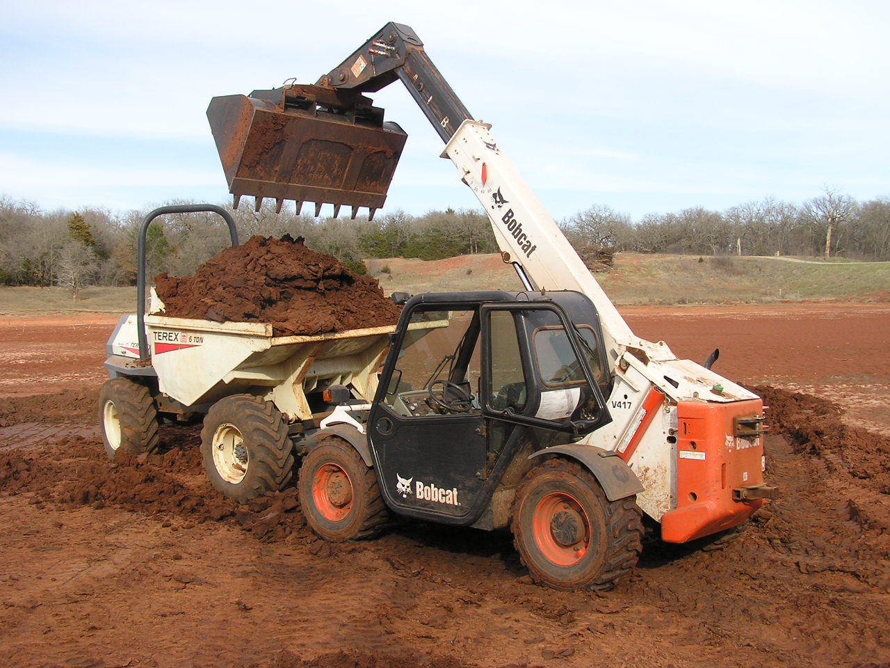

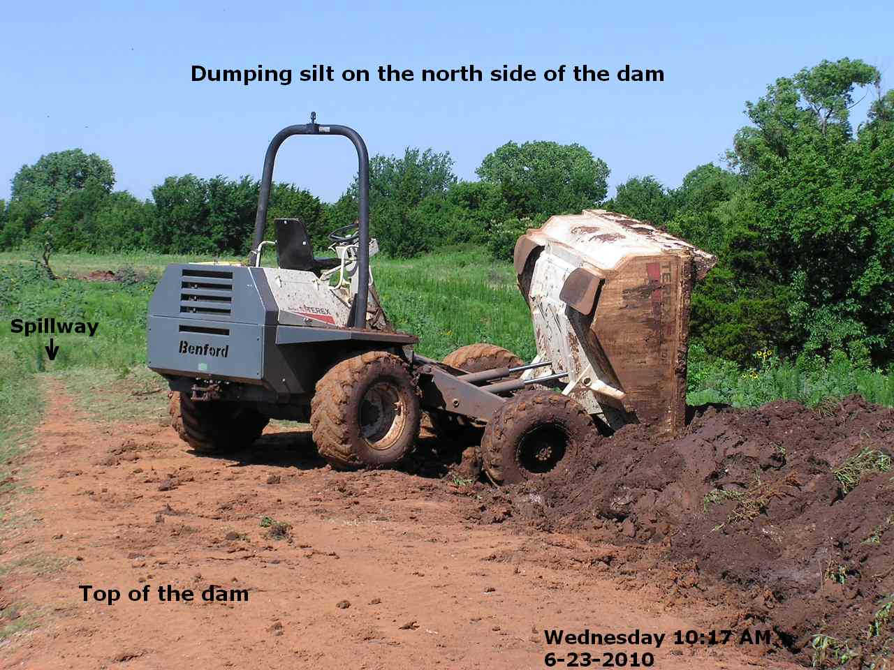

Dumpers are handy. Here is mine.
Hauling brush.

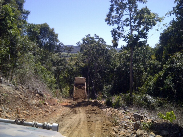

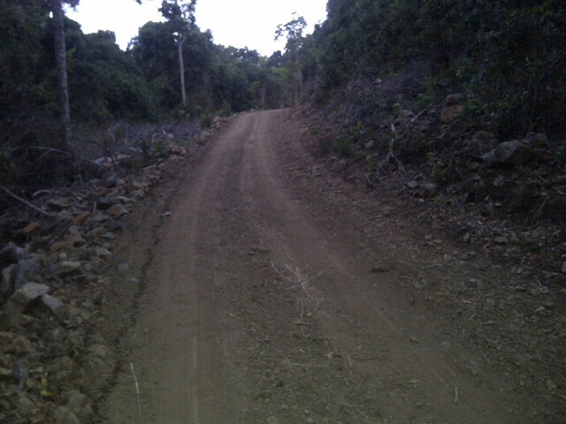

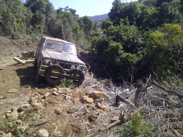

3 day long weekend and a bit of help from a mate has made a road on a steep hill that can be travelled at quite a decent speed. Pretty good for the first "base coat" anyway.
The photo looking uphill was total bush and trees a year ago when I put the dozer thru there - when I marked it out it took me an hour and a half to slash my way thru with a machete. Most of the road runs along the edge of a rocky cliff that required a fair bit of concentration on the dozer - the top end of the road is about 3 stories high straight down if one was to slip off the edge - I got a little close to slipping off that edge today.

Looks bloody good for a first "base coat" Well done:thumbsup: your mod on the land plain must have worked well
