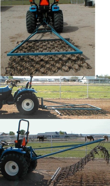

A drag harrow is just the thing you need. It's great to drag and level arenas and like the others have said to drag your pastures. To move it I would recommend making a harrow lift like the one I have attached pictures of. I would have bought one but the lift was as much as the drag! Mine only cost about $85 to make (including the New Holland blue paint). I based it on pictures of commercial ones.

   / Dragging a Pasture #29
DeanQ. You sure did a nice job on that lift. A boom pole is ok, but obviously it doesn't lift the harrow at the corners and keep it spread out like your's does. Nice work!
   / Dragging a Pasture #30
That was a nice deal he had.... I've been moving mine with the boom pole, and rolling it up.. think I may go agg a rear stiffener pipe.. then a ring to attatch it to the boom pole so it will lift on the corners too!
