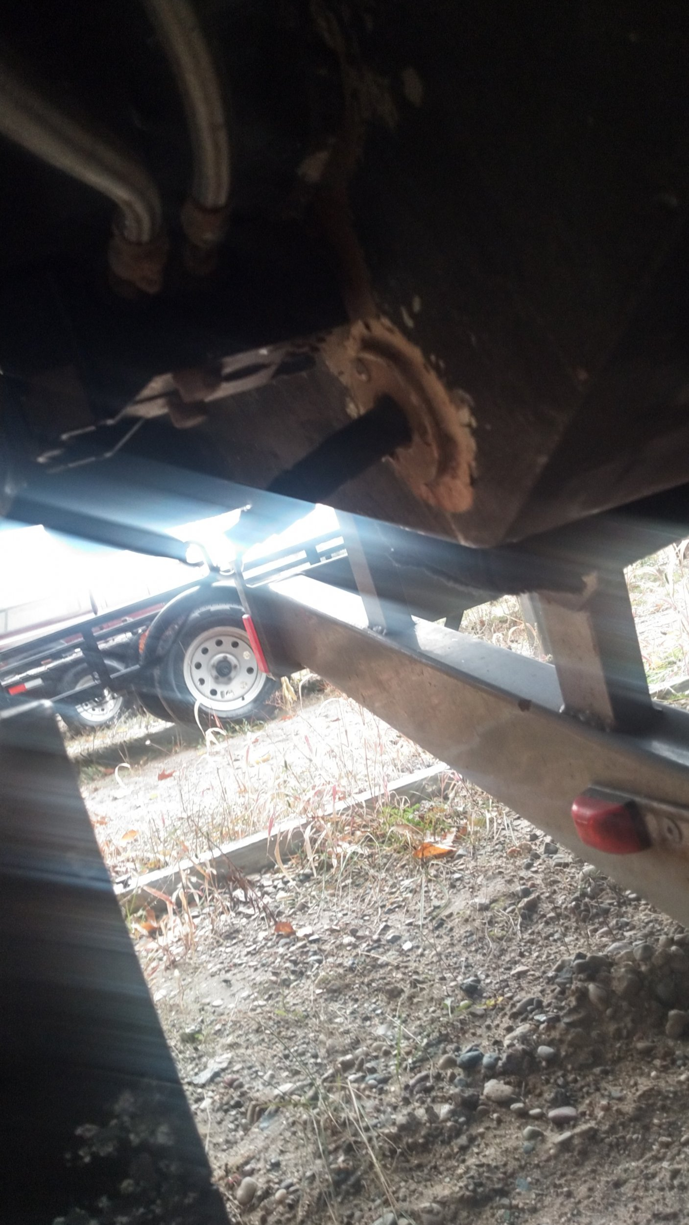

A few minor thoughts from experience, some oil drain plugs have a magnet on the bolt how are you supposed to clean it off? I heard somewhere that some quick change oil places suck it out cause they don't want there minimum wage "service techs" stripping out the drain plugs. Finally when I used to service diesel and gas inboards and I/Os on boats I used to really dislike pumping oil out of dipstick holes it took forever and I was always had to reposition the suction tube in an attempt to get it all out. Notice newer boats come with a drain hose that pulls out the bilge drain plug hole and dust on unused oil sucker. Sucking oil sucks, imo/experience.
