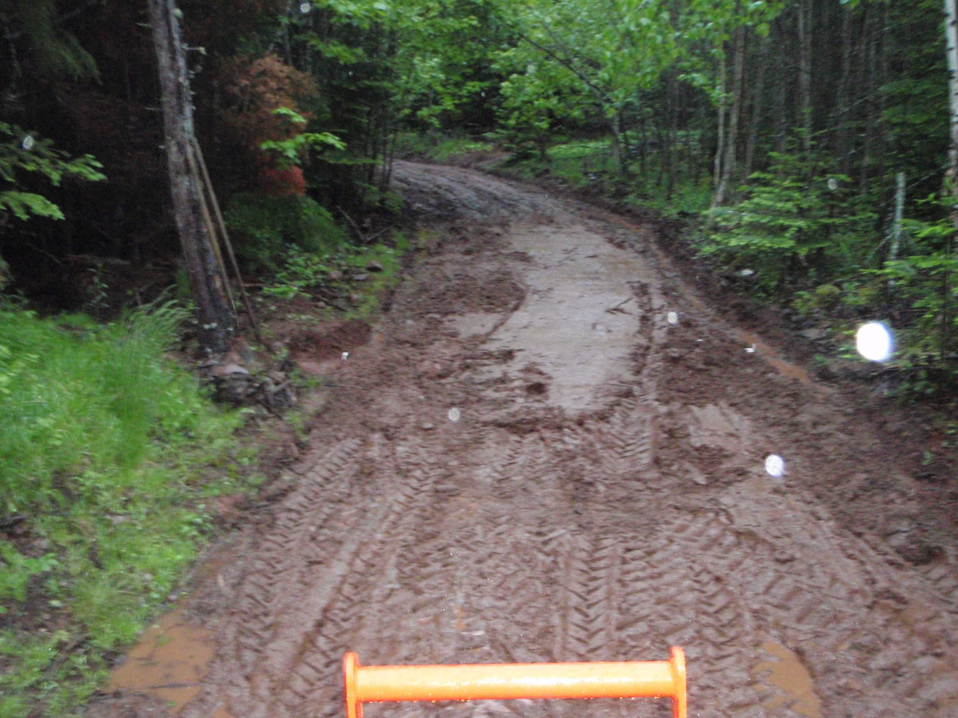

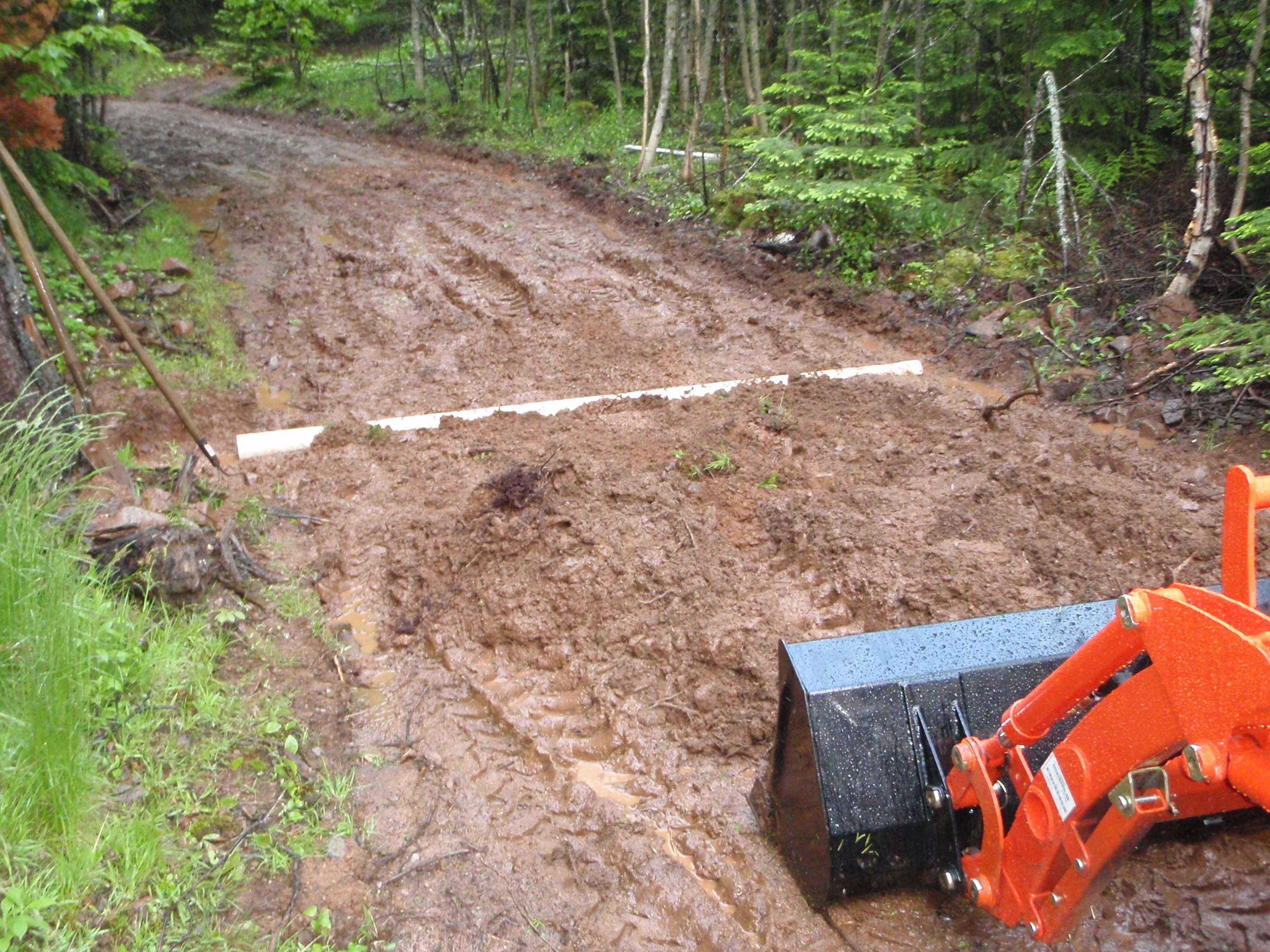

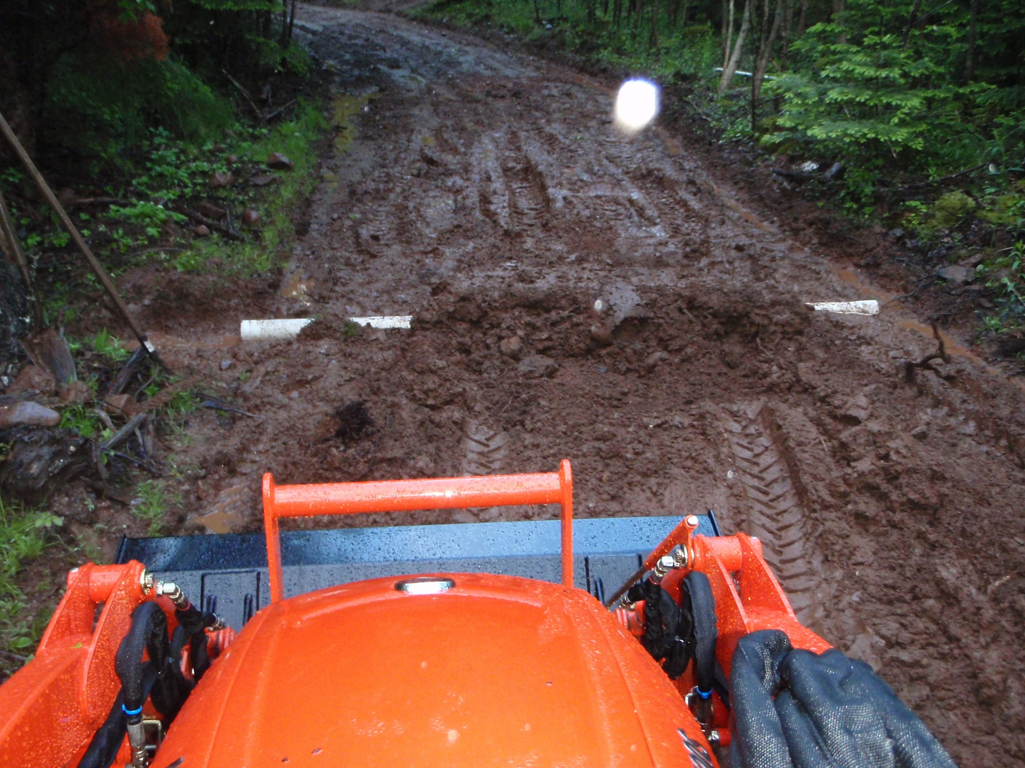

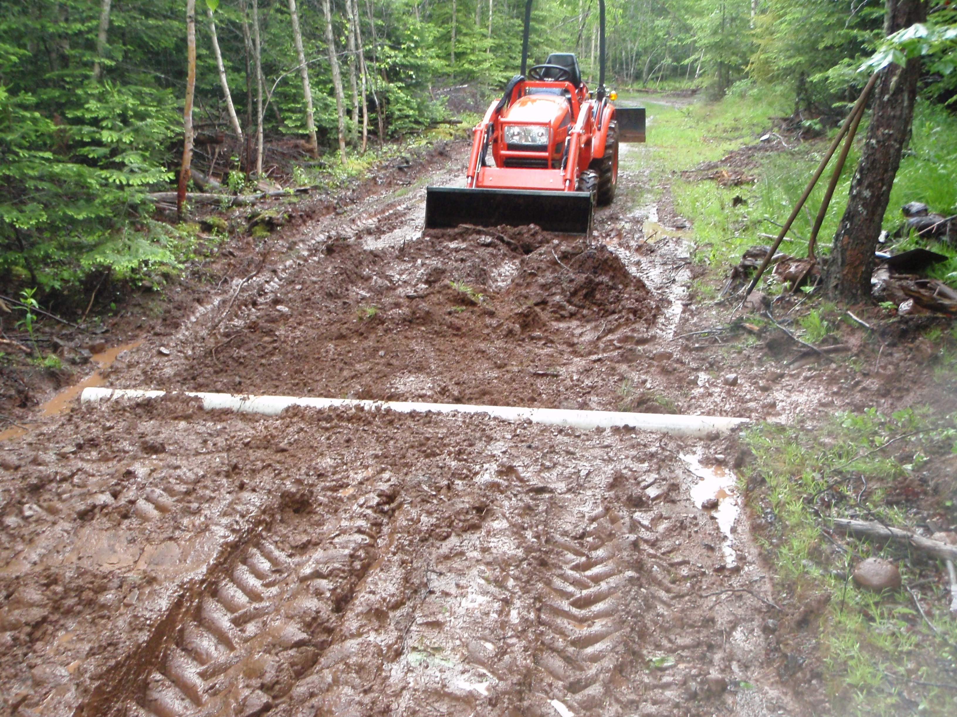

This Sat evening I finally had enough rain to find the low spot in a section of my road. This area has p***ed me off for a few years now as one of a few spots that gets very soft in the rain. I've used the tractor to add about 6-7 inches of dirt and used my blade to make a ditch. An unfortunate side effect is that the new dirt hasn't compacted enough and becomes pancake batter in a heavy rain.
I used the rear blade to scrape off the loose stuff and then started digging by hand. After a few inches I hit the compacted layer and the fun was over. I forgot my pickaxe so made do.
The pics show the pipe in and aftermath. I nearly got my truck stuck going thru that stuff this morning..how I miss a 4x4 sometimes. The tractor was a champ tho, doesn't mind the mud at all.

Yeoooow,
Now that's some serious mud!!!!

Hey Wade,
I'm certanily no drainage expert..and I'm sure the pic's don't do the site full justice.. but even with the pipe there .. where is the water going to go? Does the ditch on the right side of the pic' drain this water away? Possibly a 2nd ditch perpendicular to the road running to your neighbors yard would do the trick?
I know I know.. there is always a critic in the wood work!

That is the low side of the road and there is a sort of basin I dug there with an outlet that lets the water flow out into the woods and ultimately into the ditch on the main road. In the pic, you can see part of it just in front of the tree. I actually did a lot of research on dirt road building, maintenance, and drainage just before I got the tractor.

An old fella told me that 60 yrs ago all my land was a farm . I find random piles of rock all over it. It must have been a pain to farm because it is so rocky. If you look in the pics you can the rocks I throw to the side all the way up the road. I figure I'll use them somewhere.

I had a similar spot on the road I just finished. I contoured the road, crowning it and ditching so the water flowed to the pipe inlet. At the inlet, I dug a basin in front of the pipe to catch the water. Then I covered the inlet of the pipe with a heavy plastic milk crate, and filled the basin with stone. I put baseball size stone in the bottom and clean 57's on top. So far it's working great and i can drive right on top of the stone-filled basin. However, it will only take on so much water. But, in my case it's more than adequate for the run off.
You definitely need to find a good source for stone. My little road is only 300 feet long, and it took 160 tons of stone.
Based on all that soft mud, I highly recommend geotextile before stoning. Else, your stone will disappear into the mud pretty quickly. I used geotextile. While it's hard to get saturated ground around here right now we, during several days of steady rain intermixed with downpours, I have no standing water anywhere. The water just seems to disappear into the road while it stays good and hard. The drain pipe is working good too. We'll see how it goes when late winter saturation sets in next year. But, I'm pretty confident that with the crowning and geotextile, it'll hold up very well.

I read about the geotextiles. I think I may see where I can get it and how much it costs. The mud in the pic is a result of new dirt I put down recently. It didn't have time to compact. Nonetheless, I will look into the textile because in the spring this area will get soft.
