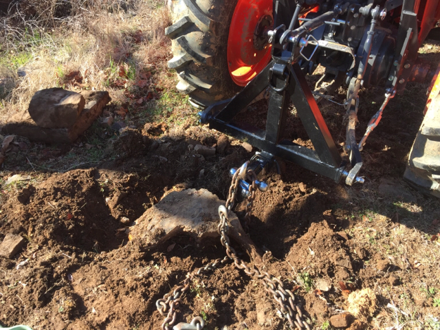

I have the Titan triangle one and use it most of the time for exactly the same purpose as yours. And carrying a cargo tray. It is bullet proof.

I ended up purchasing the Titan attachments triangle one with a hitch. Primarily because there was an open box on ebay for $70 shipped. My plan is to purchase either the Tri-ball with a hook or just get a hook or d-ring receiver at harbor freight.

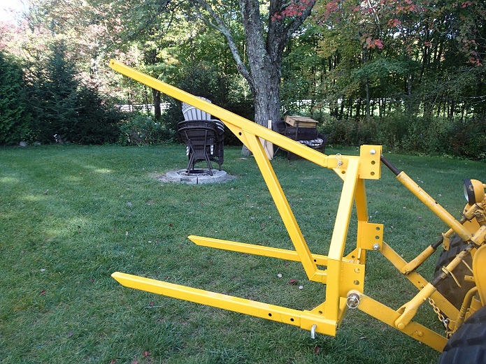

My tractor is only rated at 1438lbs on the pto so I really dont need anything super heavy duty. Other than the trailer I will probably only be dragging small trees. I also purchase the titan quick attach forks for the front loader. Ideally I would have like to have a 3 point hitch that would have allowed me to use the forks in the rear but I was unable to find a model like this other than a homemade version as shown below which is super cool and has a boom. I plan to make something similar in the future but I wanted to have something on hand when spring comes and we need to get the boat out.

I like the yellow version posted above. Lot of good ideas there.

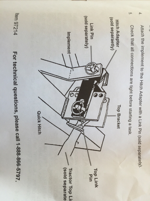

Is the top link adaptor needed for the triangle or a County Line Carry all? I am going there at lunch break to buy the quick hitch. Anything else worth buying? I hear there chains are no good.

It won't work without it on the triangle. It is a call in order only. I did it today. It was 12.79 after applying a 20% coupon. plus 6.99 shipping for me for total of 19.78 in 5-7days via USPS.
Agrisupply has it for 9.99 but the shipping was nearly 15 bucks. I think total was 24.32. I found it there by searching only the word quick hitch. There's one there for 19.99 but it's a class 2 I think with pins.
This is what it looks like.

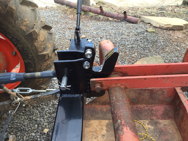

And here is where I need it first for my scoop and I hope it will work on the triangle hitch.
Be prepared to have to grind that top hook of the quick hitch inside the throat. Everyone else has had to. I got what I could on the edges with a 4"grinder and then hand filed the center down that the grinding wheel wouldn't reach.
Ok great thanks for the help. If you have some extra time could you post a picture of it connected to the quick hitch? I had planned on holding off on the quick hitch until the price drops to the sale price of $69.99. I do not really need it yet since my only two pto attachments are the triangle hitch and countyline carry all.
