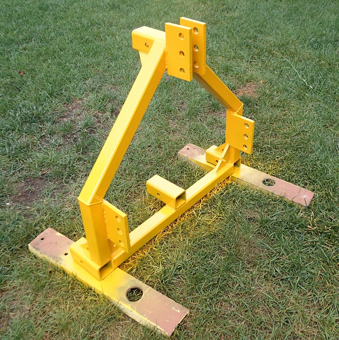

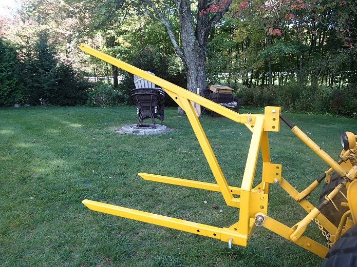

My tractor is only rated at 1438lbs on the pto so I really dont need anything super heavy duty. Other than the trailer I will probably only be dragging small trees. I also purchase the titan quick attach forks for the front loader. Ideally I would have like to have a 3 point hitch that would have allowed me to use the forks in the rear but I was unable to find a model like this other than a homemade version as shown below which is super cool and has a boom. I plan to make something similar in the future but I wanted to have something on hand when spring comes and we need to get the boat out.

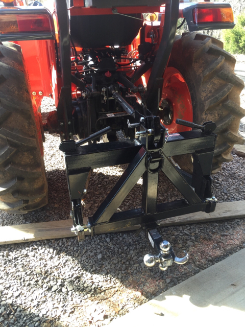

Had a little time today so worked on this.
For me the hook also is too far back. I hope to use the adaptor from HF work.
I added the class 1-2 and 2-3 bushings on the pins. And also top link bushings on the top link pink to fill the hook. I only have one bolt in it for the mocking up but I think even one good bolt or pin would be sufficient on my L3301. It would probably rear up or come to a dead stop or spin before breaking a 1/2"grade 8 bolt I would think. But the right way would be to scab on the back of the hook pushing it out. Maybe eventually.
My lower pins were a little too close together in their distance apart which caused the lunch pin to get hung up in the lower hooks. I added a couple of flat washers to push the pins out slightly.ImageUploadedByTapatalk1457126926.359939.jpg
