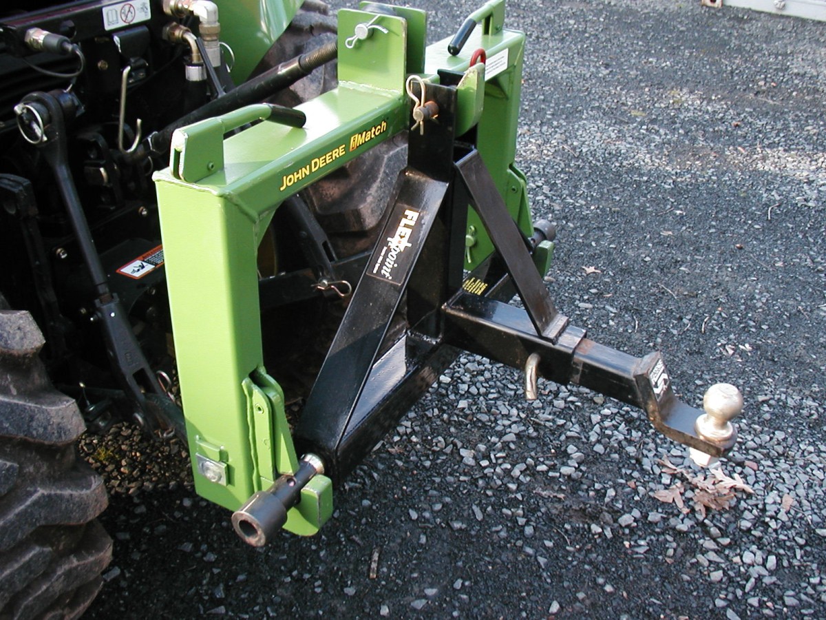

Built mine yesterday and painted it today; thanks for the wonderful idea.
/ Drawbar Hitch
#32
Looks good.
I can see a national shortage of hitches in the near future.
