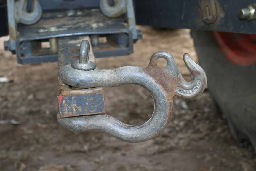

Here is another solution. This stays on my tractor at all times. I found three of these big industrial shackels at various places. very strong. I welded an extra chain hook to this one. Also works with rope.

I really like your soultion. I almost went with a similar solution. If I could have found a big shackel in town at the time, I probably would have.
I was thinking of using a large shackel like yours, but with a bushing to prevent wallowing out the trailer ball hole. (which I may use some day) Instead of welding on a grab hook, I would have ground the shackle down to 1/2" thick so a 3/8 grab hook could be hooked to it. (a 3/8" grab hook's bite is 1/2" wide)
I bet there are 57 different ways to solve this simple problem. /forums/images/graemlins/smile.gif
