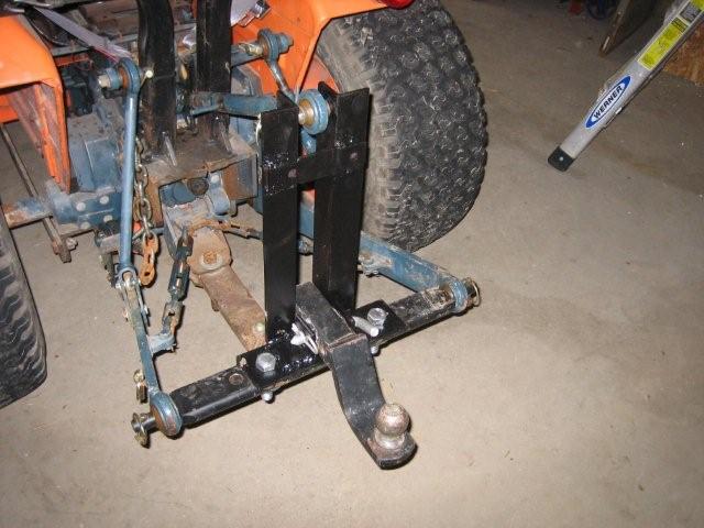

I decided to go with the toplink version. I didn't want to spend money on it since I had plenty of scrap around so here is what I came up with. Might not be as pretty as some as the others, but it will serve its purpose.

Looks good to me, pretty nice scrap. How do people live that don't have welders? big dan

dvan, that's what I had pictured in my mind.
The part from TSC is designed to work with the larger draw bars. Mine is smaller and therefore has some slop in it. When towing my trailer the ball bounces back and forward slightly. I'm going to return it and then print a photo of dvan's and go to my friendly neighborhood welder. :)
