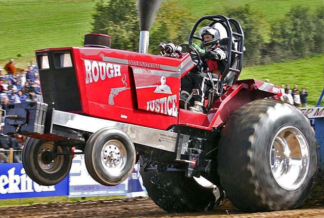

   / Drawbar pull capability #48
For normal use hp, tires and weight are very important.
For the maximum pull hp and tire speed start coming into play.
low hp and good rubber;
A lot more hp and cut tires with very little tread;
