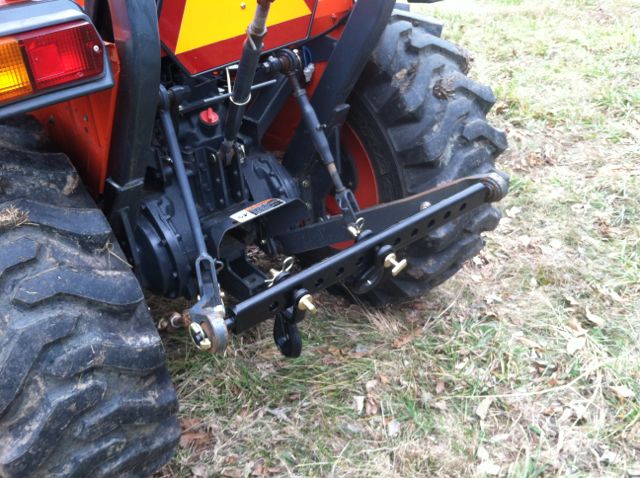

New tractor owner trying to get it figured out. I went to Fieldmans today and picked up a draw bar. I need to be able to pull some down logs, etc. Nothing to major.
When I install it, I assume I am doing it right, but I feel like I am missing a piece as it just spins between the two point hitch. I would think it should be rigid and not spin, so I could put a hitch ball or something on there...
Am I missing a part, or is this normal?

If your skidding logs with it, the way you have it is fine. It will spin around when you put tension on it. Only time you might need it rigid is if you have a ball on it and are pulling a trailer.

Use caution pulling from the 3pt arms. The higher you raise the arms, more leverage the log will have to pull front of tractor off the ground.

Only the straight drawbar which attaches to the underside of the tractor will prevent a rear rollover if your tow hangs up on something.
The item you have should really be called something other than a drawbar, because it does not provide protection against a rear rollover if your tow hangs up. And, you don't have to have the arms raised for this to be a problem. The 3-pt hitch has no down pressure and the arms will raise all by themselves if an overturn situation develops.

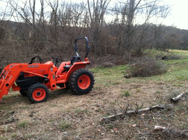

The problem comes from lifting the log too high and getting the attachment point above the axle. The problem is amplified when going uphill. Happened here this fall. An old farmer was dragging trees up a hill chained to the three point hitch. hitch got too high/stump stuck on something and the tractor wheelied over on him. He was 81 and probably couldn't react quick enough to clutch the tractor to bring the front end down.
I'm not the safety police and I have done this exact same thing chaining the tree to the center hook on my 3pt quick hitch. I always go very slow and keep an eye on the stump end. It is nice to drag trees with the stump a little off the ground. You just have to be very careful.
