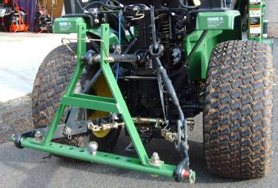

Attached is a picture of a TSC drawbar, with a top link made to keep it from rotating. Hiding behind it, behind the lower right of the triangle formed by the greenery, is the actual factory drawbar. On my JD 4010, the factory drawbar has 2 holes to attach things. Only problem is they're to/fro holes. On the TSC drawbar, I can leave my ball for my Gravely cart in the middle and attach other "Y" hitch stuff to the side or raise and attach to the factory drawbar.
Ralph

I'm sure our answers are why you’re asking. Both are drawbars. The correct one to use for pulling is the one mounted to tractor frame, not the 3PH lift arms.

Keep in mind that not all tractors have the swinging drawbar.. and that a proper drawbar stay setup, used with a 3pt drawbar can be just as 'correct' for pulling, within reason.. etc.

Your are right. I forgot about many of the older Fords and similar tractors required a add on for the draw-bar. My Farmall 340 did not have one either.
The important thing to remember is the limitations and proper setup of any of the draw-bars used.
