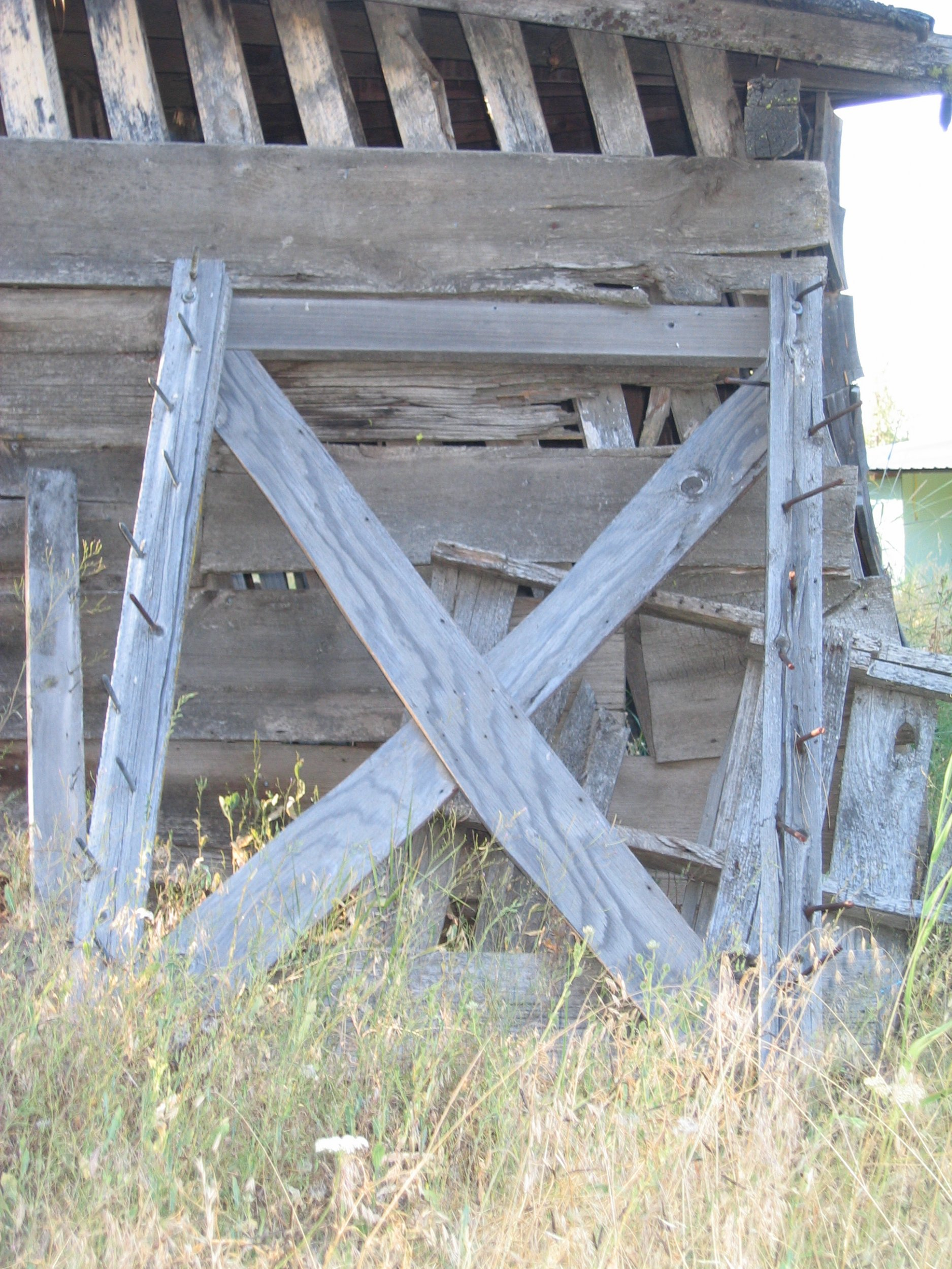

A cheap option that might work as well as your landscape rake. Make a DRAG. Mine is home made and towed(unweighted) with my ATV. When weighted( 400# concrete cube ) - it's towed with my tractor.
Round & round I go. After a few passes - even the roughest field is smooth. I use it with the teeth down or teeth up. I also have a land plane grading scraper (LPGS) with scarifiers that does well at smoothing and leveling.
