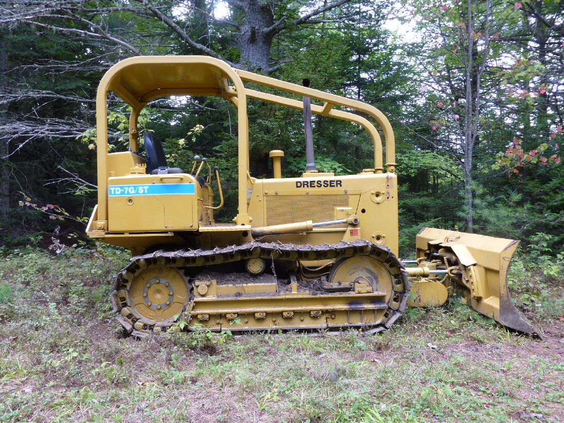

A TD8E is more than a JD 350. TD8E dozer with standard ROPS, blade, all oil, fuel, and operator is spec'ed at 16,980 lbs. Tractor only dry weight (no oil or fuel, no blade, no ROPS) 12,745 lbs. I think they are 80 or 90 hp. Same 239/240 motor I have in the TD7 but turbo charged. Mine is 70 hp w/o turbo.
