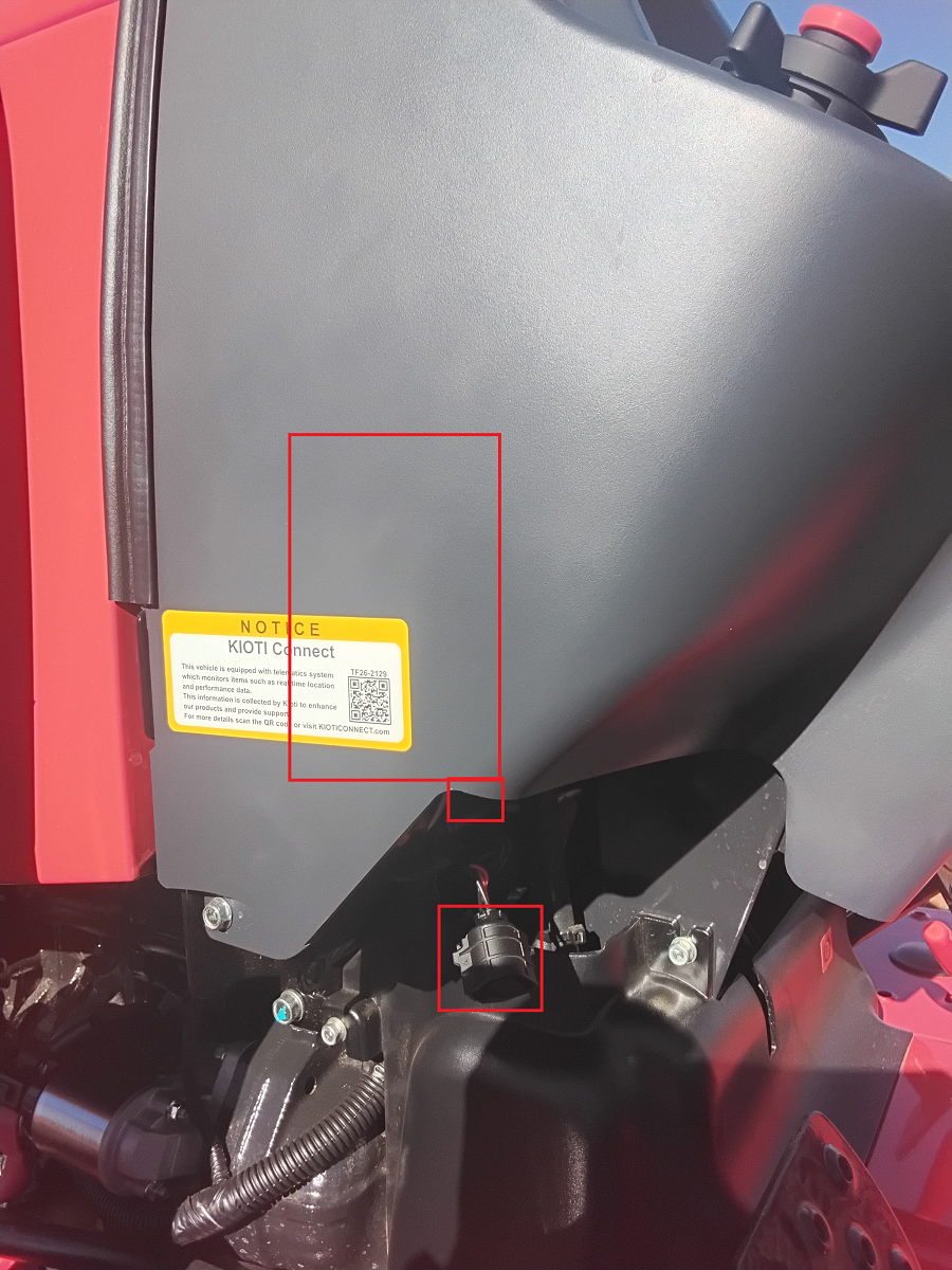

As of 12/2025, the CK2620 is delivered with a telematics unit on it that tracks the tractor and sends the info back home to Korea, complete with GPS coordinates.
I'm not sure about any of you, but I did not buy a 25HP no emission control, dead nuts simple tractor in order to have big brother ******** attached to it. Nowhere did I find Kioti advertising any of it.
Anyway, hypothetically if you looked at the left side of the dash compartment, from below, you can see a "FCC" label on one of those units. It is the most leftmost computer module on this tractor.
Hypothetically, simply unplugging it, and the "KIOTI connect" big brother tracking is Kaput.
Is there any other electronic ******** that I should be aware of on this tractor that can simply be disabled?

I can tell you with 110% certainty the very newest CK2620 have the telematics unit on it and not just the maintenance tracking. I downloaded the app and it showed the exact position of it every trip. Until I unplugged the module with the "FCC" label on it that was transmitting live information while it was running, after unplugging the mapped "work history" no longer show up on the app.
They do not advertise this anywhere. I suspect they know people buying CK2620 want an 'old school' simple tractor and that it is not a selling point. I'm guessing I got one of the first ones with this "feature."

It is nice that Kioti has at least made the electrical harness connector easily accessible; if it were not the lateral most module it would be more difficult to disconnect; and also nice it doesn't appear to break anything or interlock the engine if the telematics is disconnected.
On point (5) I am 100% sure it's Kioti. I paid cash and have no insurance. The module is clearly OEM and works through Kioti's app.
