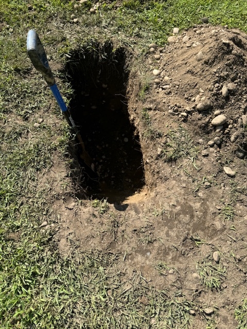

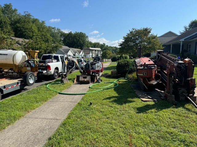

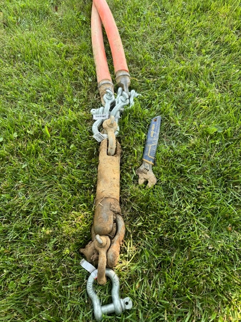

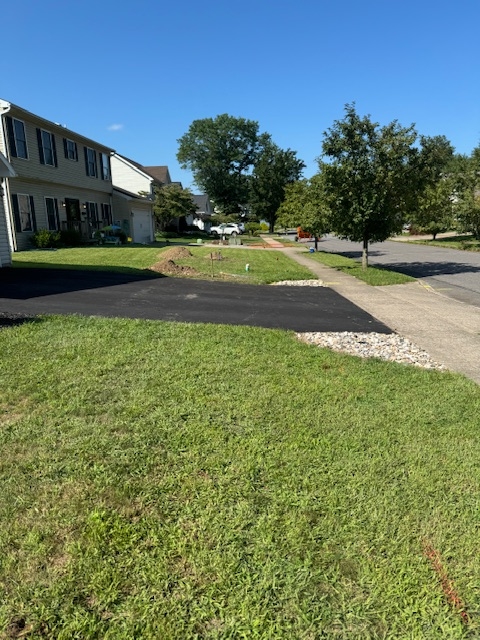

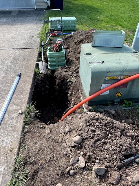

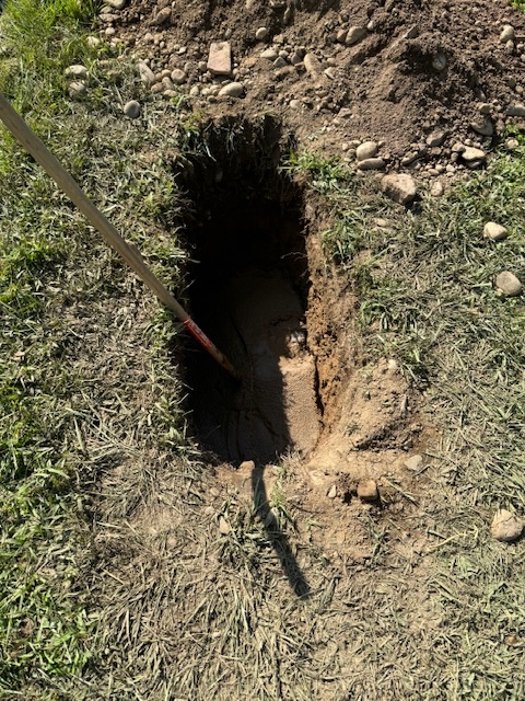

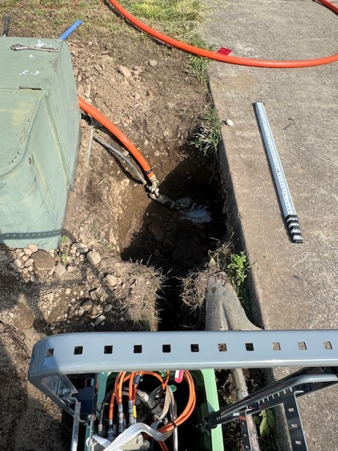

The the ground has been frozen or then frozen and top melted(0 traction). So I’ve been almost only drilling. Here are a few pictures.
