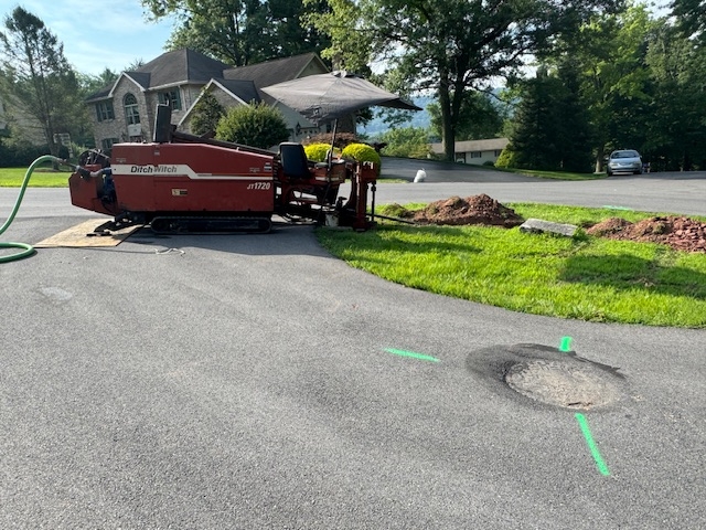

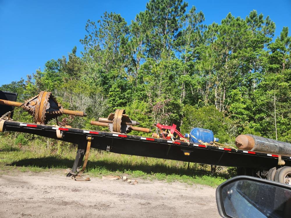

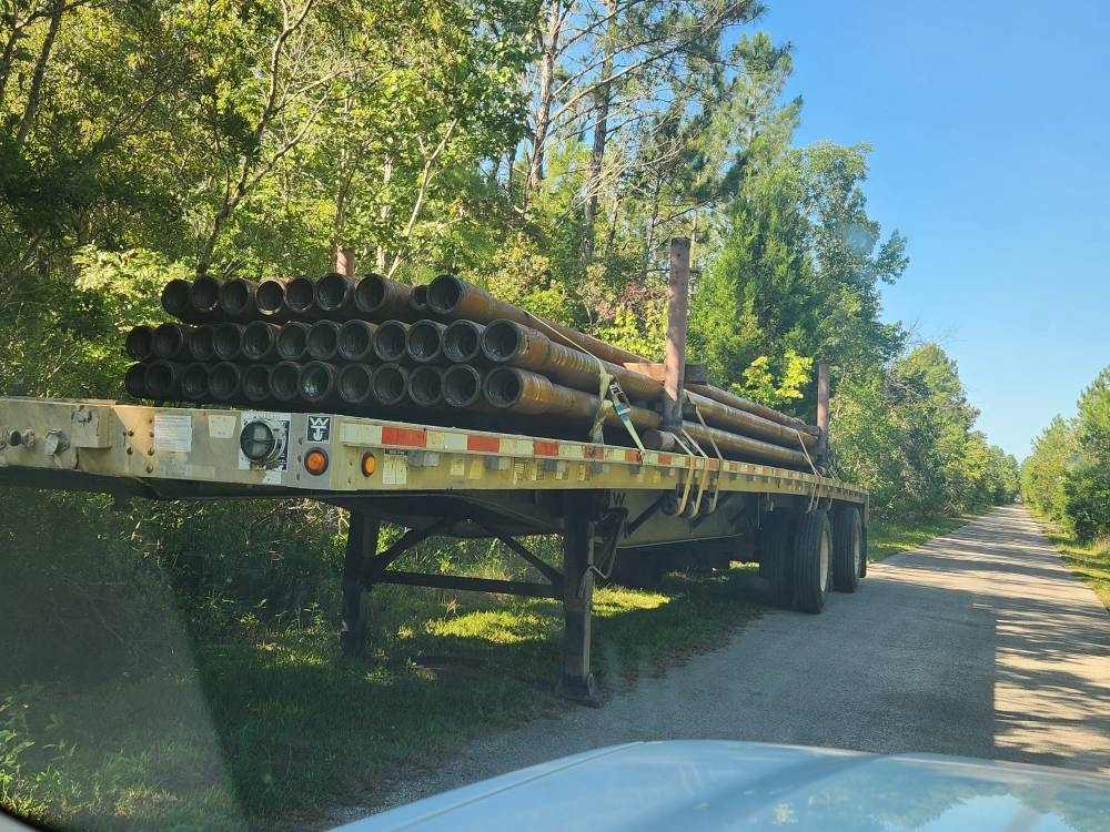

Got a 16", 680 shot coming up late next week; and reviewed drawings for dual 24" shots at 1200 ft long. If I think about it, I'll take a picture or two of the reamer, mud reclaimer, ect. It's a whole different operation than the small 350 ft 4" shots, and it both takes Far longer, and pays Far more.
   / Drill baby drill!(Directionally, HDD content) #45
Don't want to upload anything showing company names, ect. But here is the drill for that 16" shot.

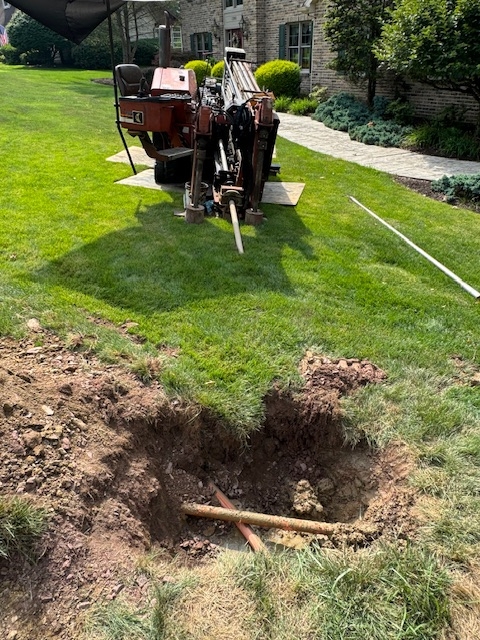

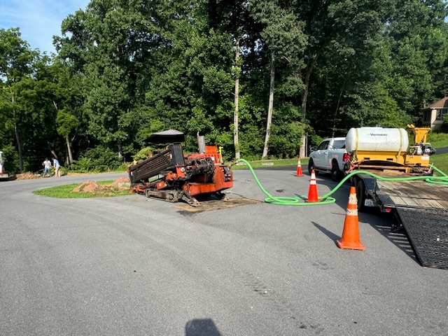

Had to do three drills for this 400ft run. Drill pull, drill pull, plow, drill pull then plow to ped.

Week ago this past Saturday, we finished up a 1300lf pull back of 30" behind a 42" reamer, with a Veermer D1000x900.
Maybe I shouldn't say We; I was just keeping an eye on the road for damage/heaving/frac outs (or as they want people to say now, unintentional fluid returns)
