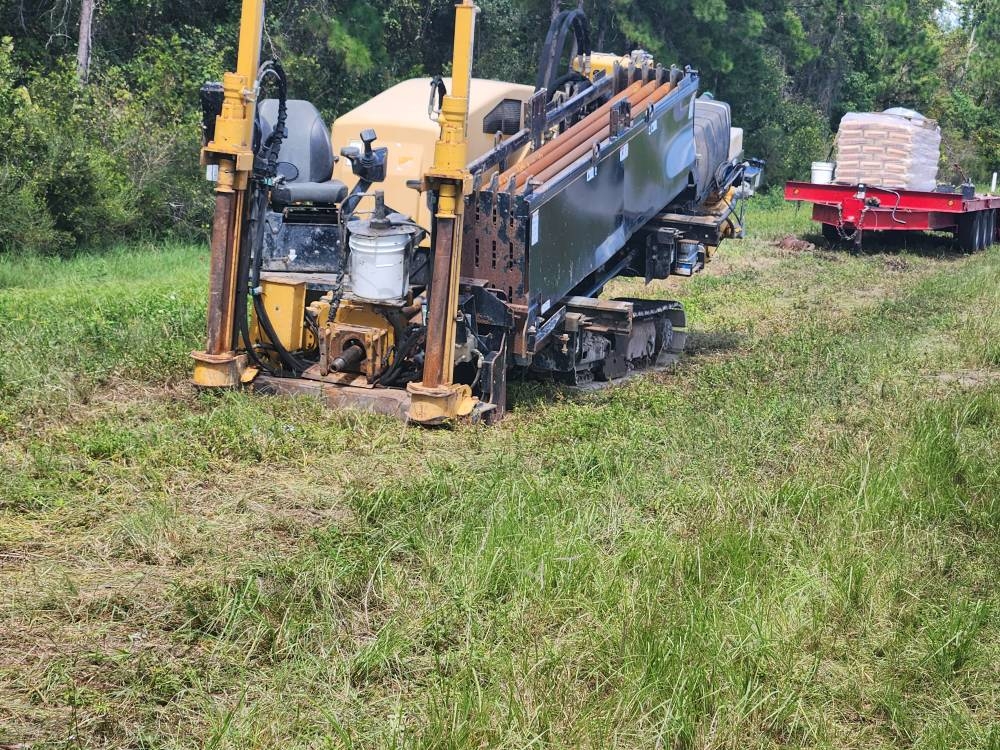

I'm guessing Mr Fixa got this drill pretty cheap, but I'd bet the set-up was still not Cheap. That mini in the picture, is what, $65k new?
A new one of those with cab is close to 100k after taxes. I bought this one used. The only thing I bought new was my first small 2 ton excavator.

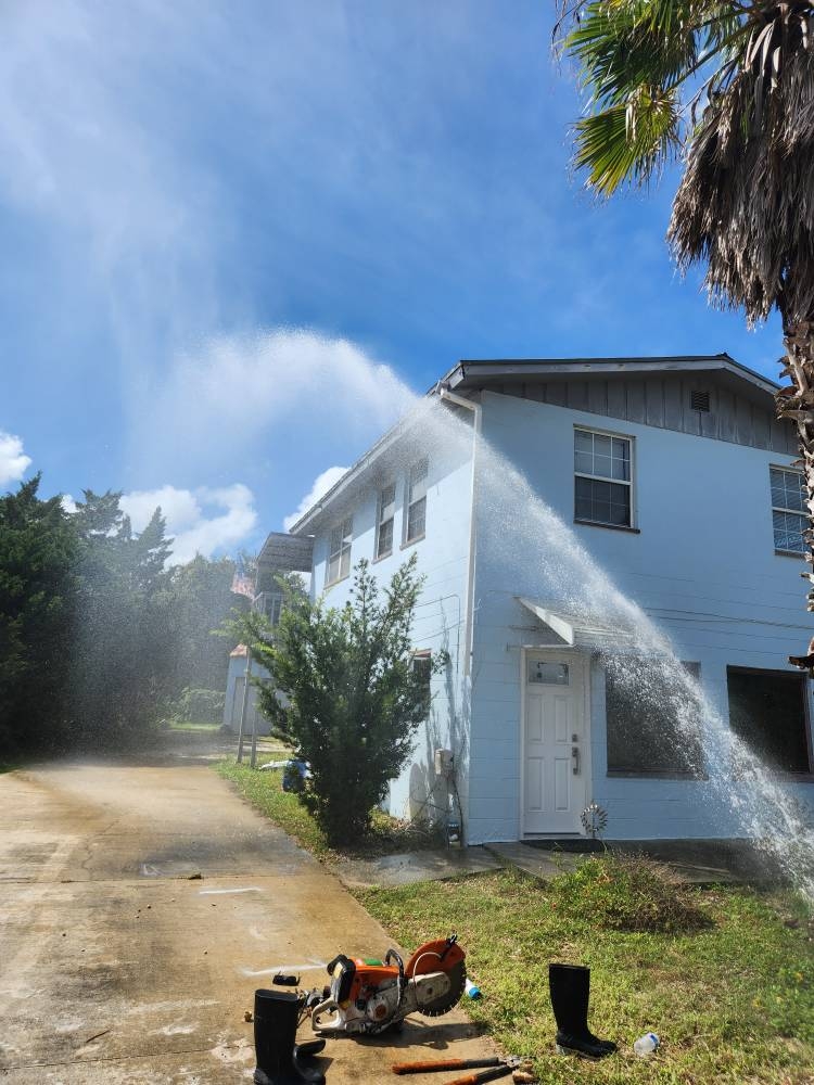

Got sent to go investigate this today. Drill hit the water service, no real damage to anything beyond the Corp stop and the service line to the meter box.

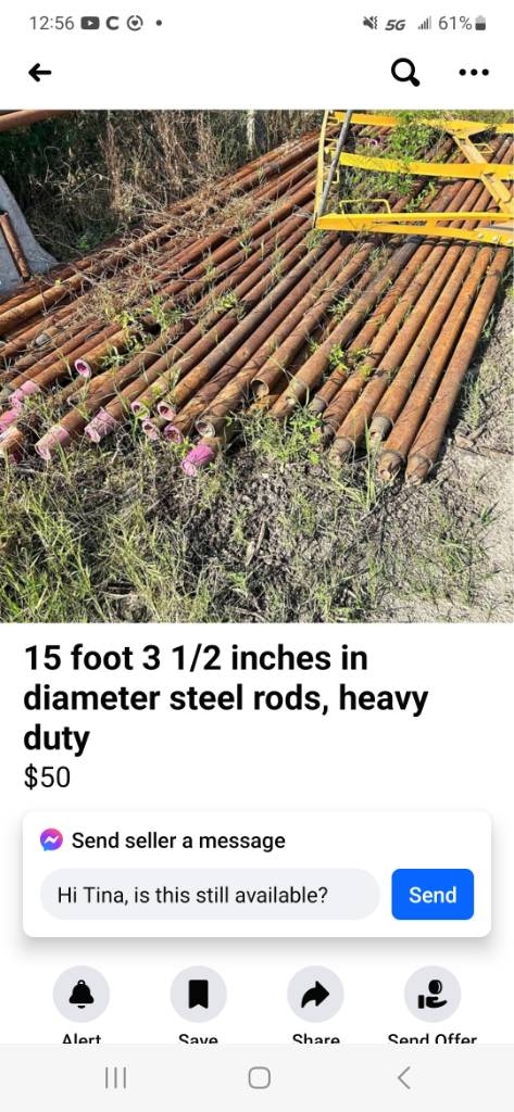

Someone in Jacksonville FL is selling 15 ft HDD rods, still has thread caps, for $50/rod.
