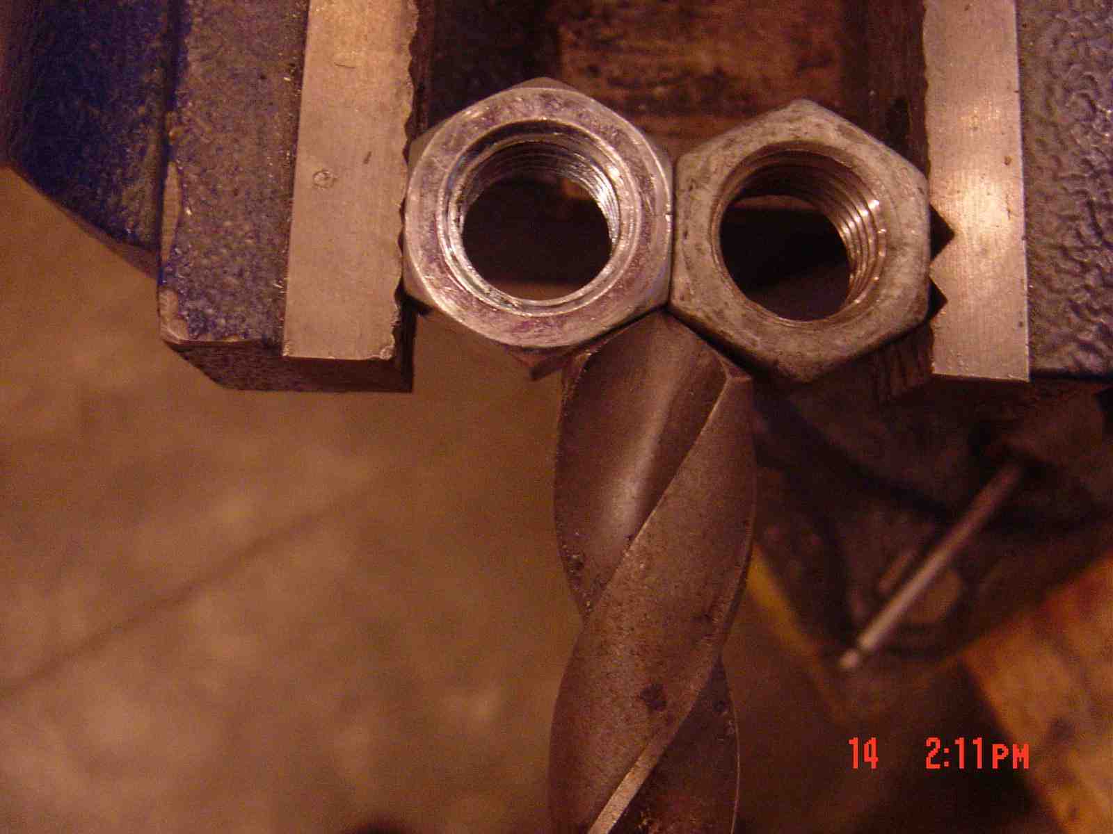

Here is a cheap and easy way to check the proper angle of a drill bit. Most of us here have two of these. :D
   / Drill Bits - Need some help and advice #45
I dont fuss too much about getting the angle perfect. Just make sure they are equal so both edges cut. I have actually ground some bits to 80 degrees in a pinch when I didnt have or couldnt find a countersink for a FHCS
