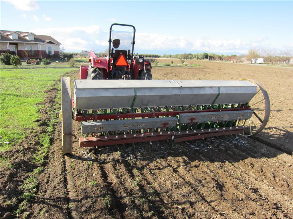

I bought two very old Minneapolis Moline P3-6 grain drills (10 ft wide, 20 drops, single disc openers) for $275 and used parts from each to build a working unit. Used it for several seasons to plant Kanota oats. Total cost: less than $500.
Drill-6.JPGM5525  drill-1.JPGM5525 drill---3.JPGKanota oats-1.JPGKanota oats-2.JPG
The nice thing about drills is that you can get your crop planted in one pass. If you broadcast the seed, you generally have to make another pass to cover and press the seed into the soil.
