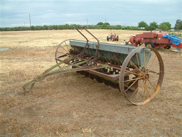

I went to check on a 10' cultipacker on craigslist today. Good thing I took extra cash. I did manage to get the packer, as well as an Oliver Superior grain drill. It is a model 64, serial number 64-4723. The unit has 17 rows, two large boxes on top, and a smaller (3"x3") box on the rear. Previous owner used it 3 years ago, then let it sit outside. It is going to need some PB Blaster, sanding and paint, and a couple tires. I am planning on using to plant a 5 acre food plot for wildlife. If anyone has manuals or knows where I might find copies please chime in. Here are some pictures of todays haul:

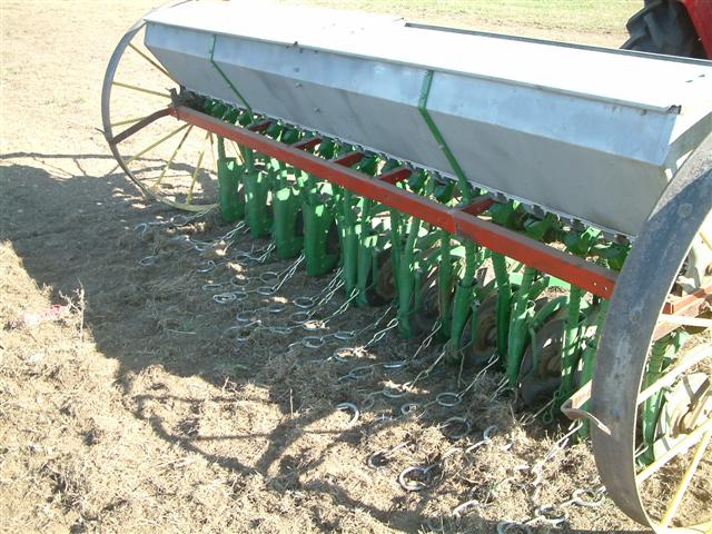

A few years ago I restored an old Minneapolis Moline P3-6 grain drill (10 ft wide, 20 drops, single disc openers, 6" row spacing). Bought two of them from a neighbor for $275 and used parts from both to make one good operating drill (the other drill is a lawn ornament). Added about $300 in new parts. A fun project.
Drill restore-1.JPGDrill-1.JPGDrill-2.JPGDrill-3.JPGDrill--4.JPGDrill-5.jpgDrill-6.JPGDrill-hyd ram.JPG
<img src="http://www.tractorbynet.com/forums/attachment.php?attachmentid=305897"/><img src="http://www.tractorbynet.com/forums/attachment.php?attachmentid=305898"/><img src="http://www.tractorbynet.com/forums/attachment.php?attachmentid=305899"/><img src="http://www.tractorbynet.com/forums/attachment.php?attachmentid=305900"/><img src="http://www.tractorbynet.com/forums/attachment.php?attachmentid=305901"/><img src="http://www.tractorbynet.com/forums/attachment.php?attachmentid=305902"/><img src="http://www.tractorbynet.com/forums/attachment.php?attachmentid=305903"/><img src="http://www.tractorbynet.com/forums/attachment.php?attachmentid=305904"/>

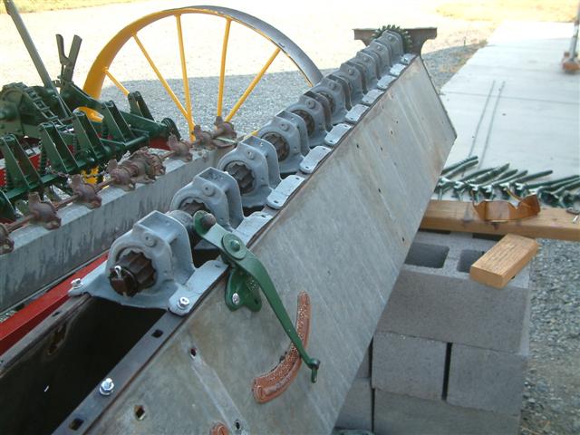

Thanks. The seed cups were pretty rusted. I got them apart.
Cleaned the loose rust off.
I coated the fluted feeds (black parts) with Gemplers Rust Converter to slow down the oxidation process.
I used cold galvanize spray coating on the seed cup housings (grey parts).
The galvanize coating on the boxes was rusted in spots so I coated the outside surfaces with the cold galvanize spray paint.
