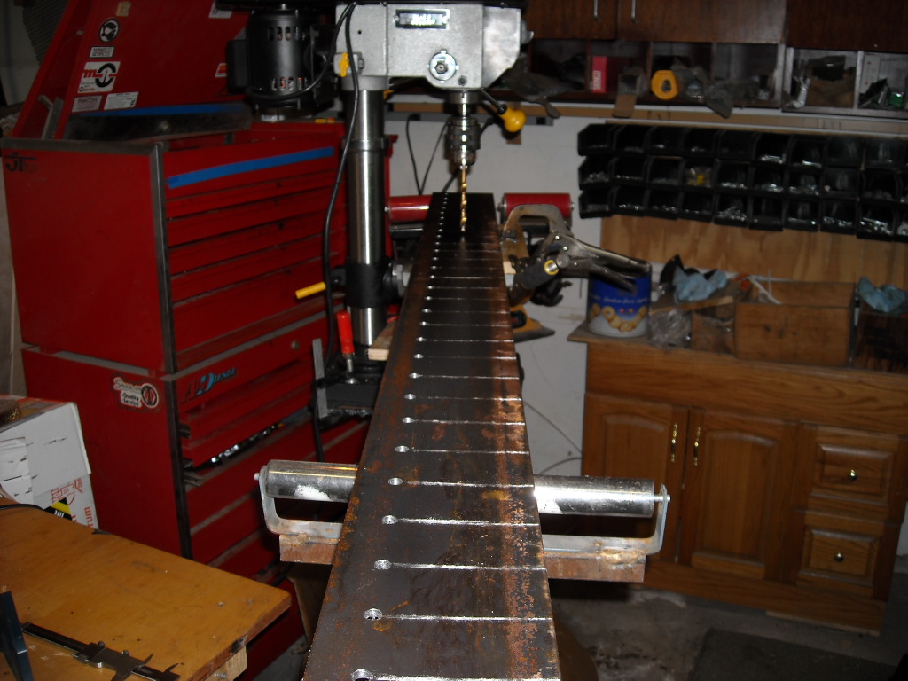

No drill press!!!???!!! Man how did you get by? Bought a HF benchtop about 20 years ago, just retired it by giving it to a guy at work. I already had a drill press in Elkhart so I didn't need it. The thing about a drill press is the drilling is MUCH easier because of the simple downforce you put on the bit with the gears. Put all your weight on a hand held drill, or one hand it on the DP lever.
I swapped out the old DP for another HF model. more speeds and a little newer. I have it mounted on a pedestal. Hey it's cheaper than a floor model and everything I drill is smallish. Works great for drilling 60 holes while making a rake for the tractor. Put a block on the table as a guide and just slide it down to the marks. Less than an hour with cool down breaks..
Coupld pics...1st pic you can see the old and the new.
Rob
