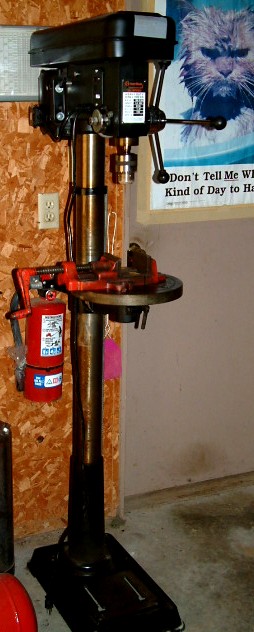

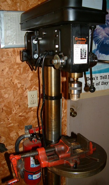

just picked up this floor model used off of craigslist. paid 150 for it. 14" swing, 3/4 hp capacitor start motor, integrated light, 5/8" chuck, 4" quill travel, 16 speeds. they threw in the clamp for the price which is a heavy duty older clamp. the press is a 1988 guardian power company machine. i was unable to find a current reference on google and was a bit worried about getting parts for it, but it looks almost exactly like the same machine grizzly is selling for around $250 without the clamp.
amp
