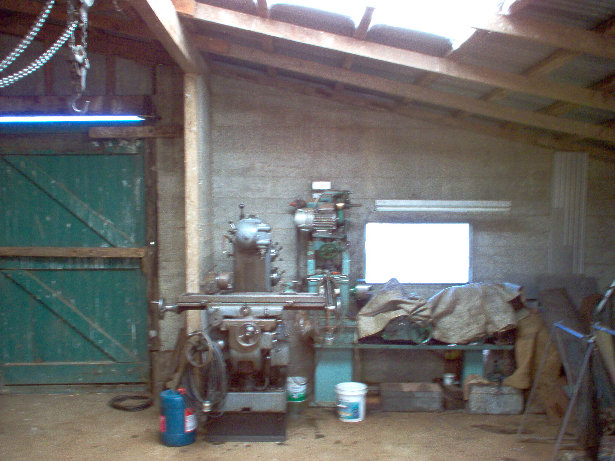

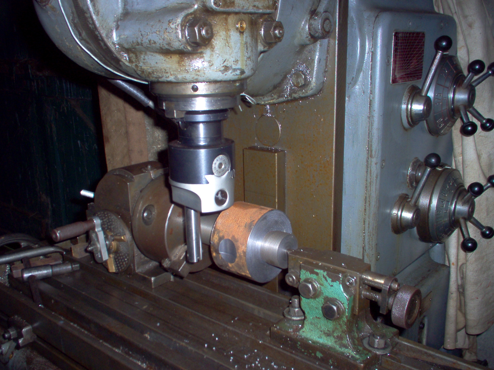

A Mill is very handy and can do things a lathe can not do.
Here is my Mill with feeds in all directions.
Its old accurate and is both cross and verticle

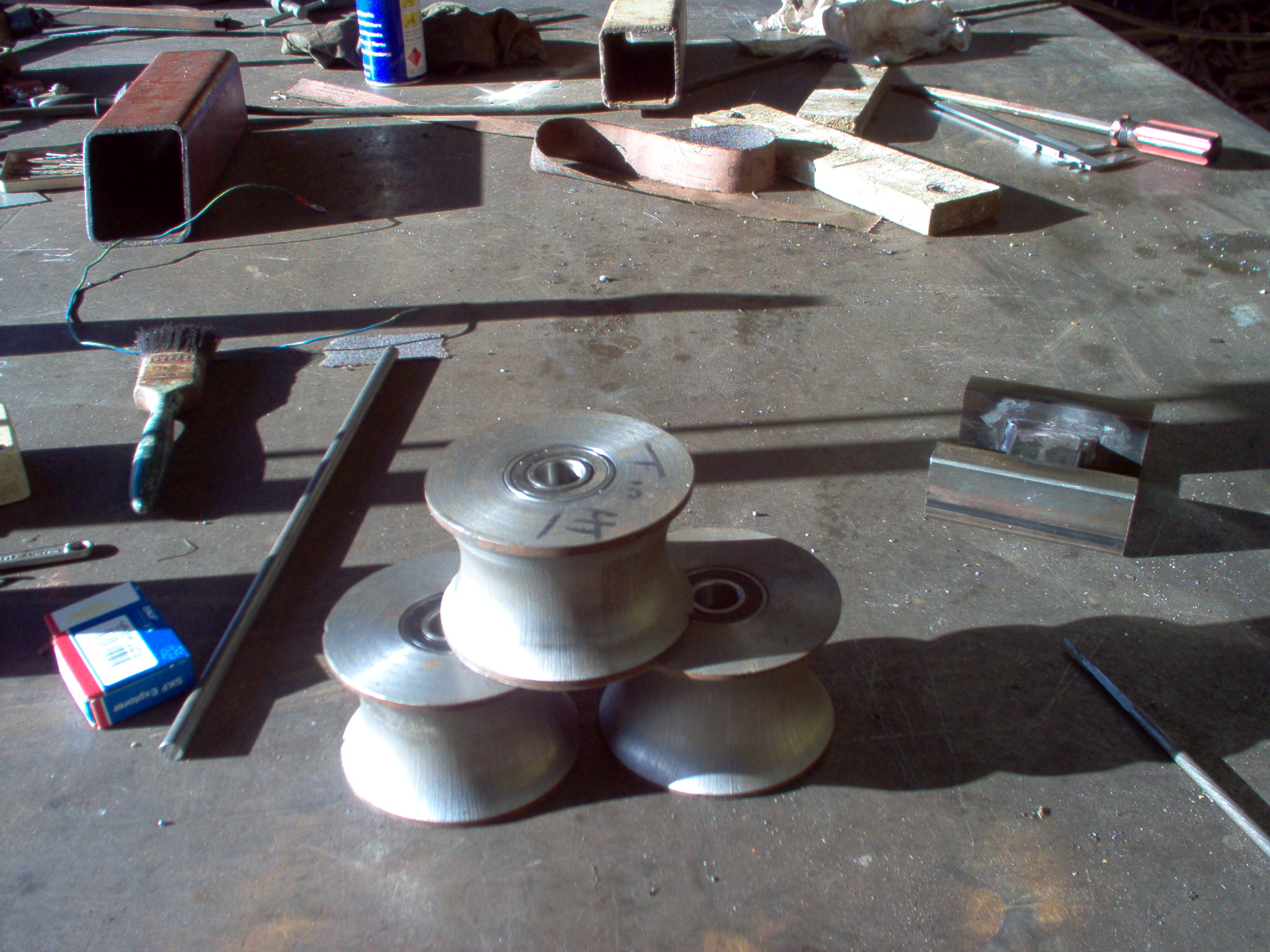

Here is some rollers that I made on the mill.

That's good to hear right about now. Those rollers look great, they for a tube bender?
