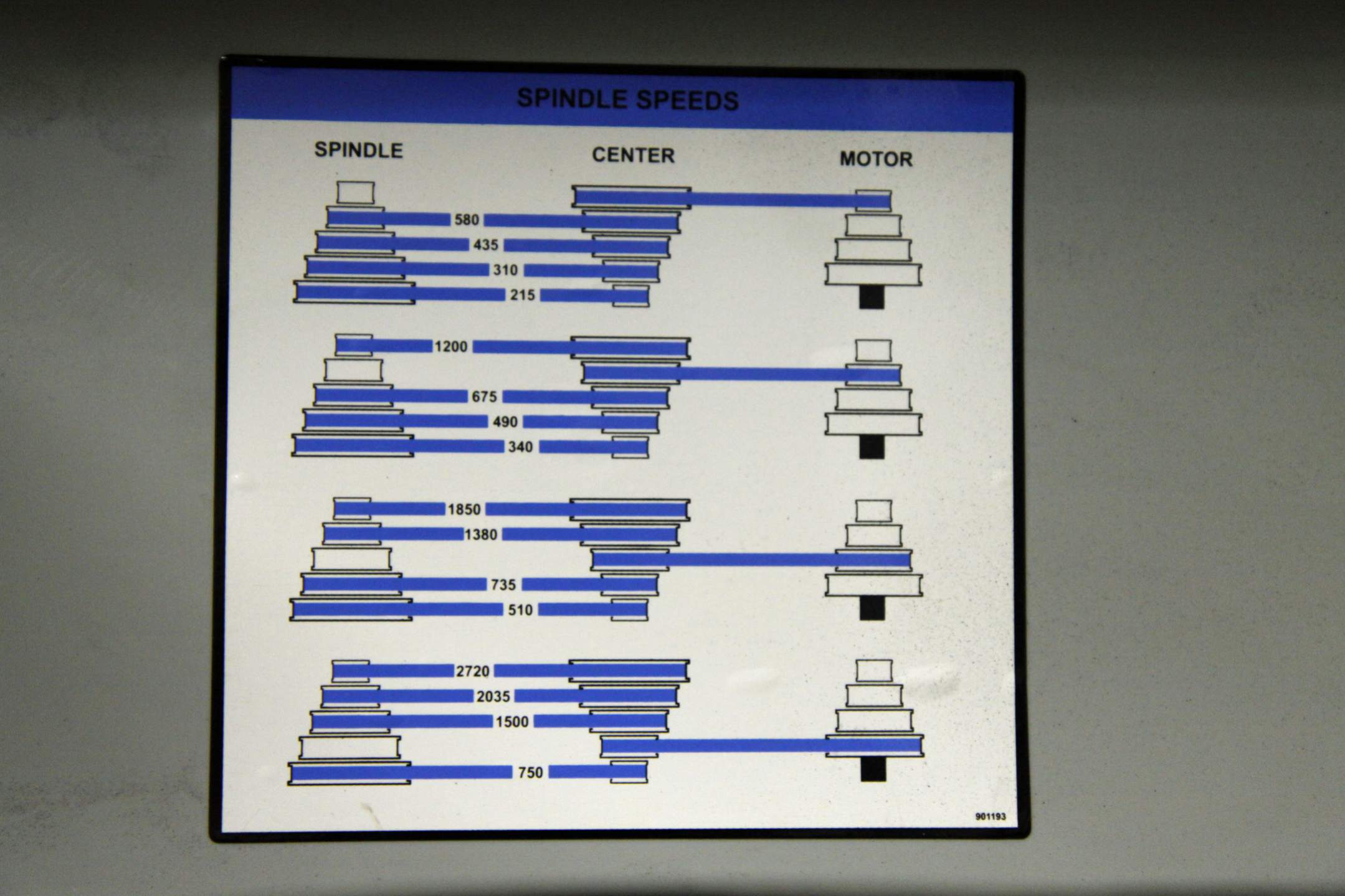

heres what my little old Delta has..and its about 10 years old. Model is still made..
   / Drill Press RPM for steel #50
My only concern with a speed control, is its going to reduce the torque and power of the motor also. If a simple dial control would /could control a drill press they would be using these instead of a series of pulleys.....just to save $$$
when i slow down the speed of my grinder, its way easier to bind up the disk during grinding...less POWER. so if you did this to a drill press, it might not be able to actually drill thru the steel????
