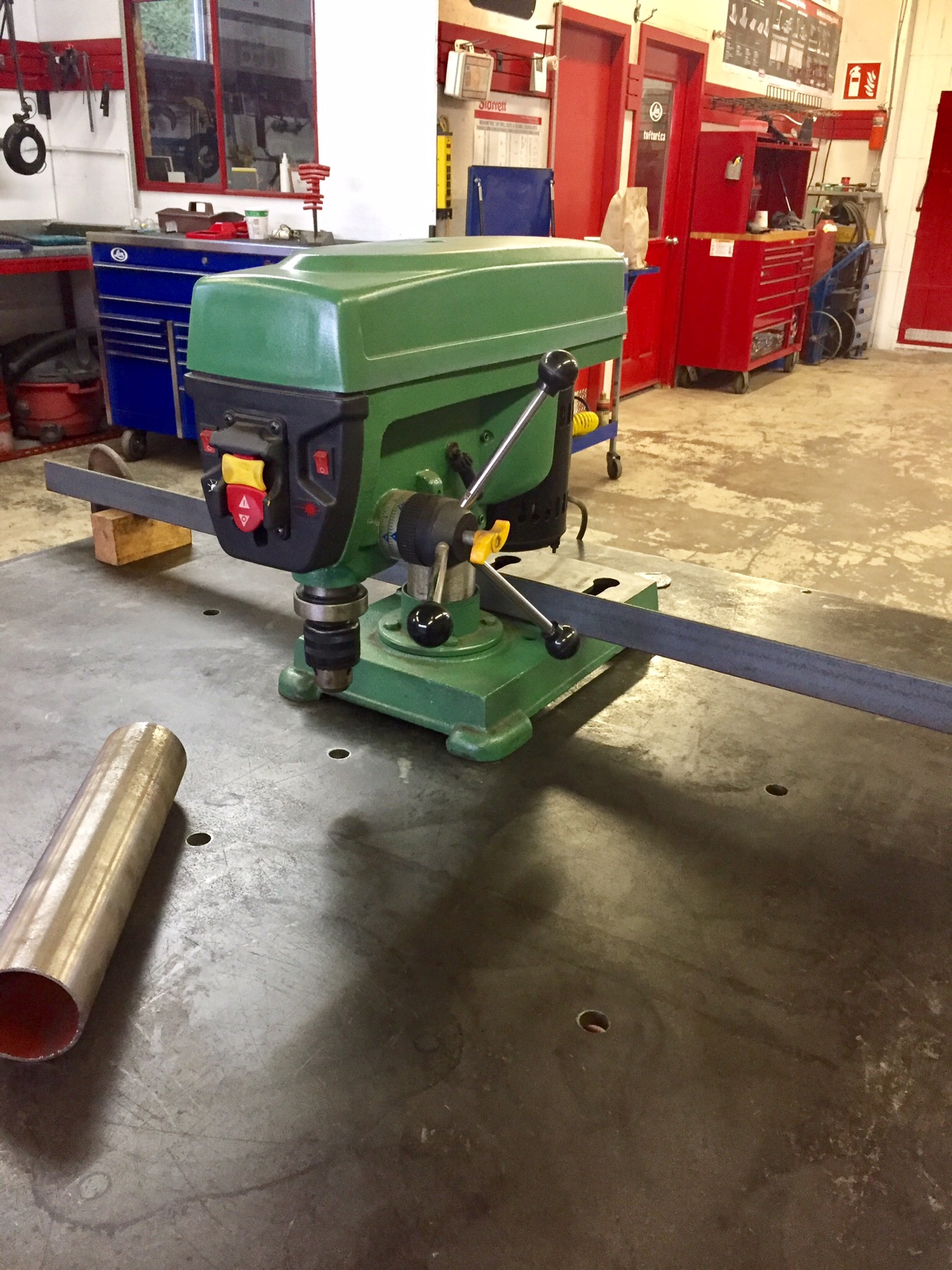

Before I bought my mag drills I turned the headstock on this cheapo drill press 180 degrees and clamped it like you were suggesting.
