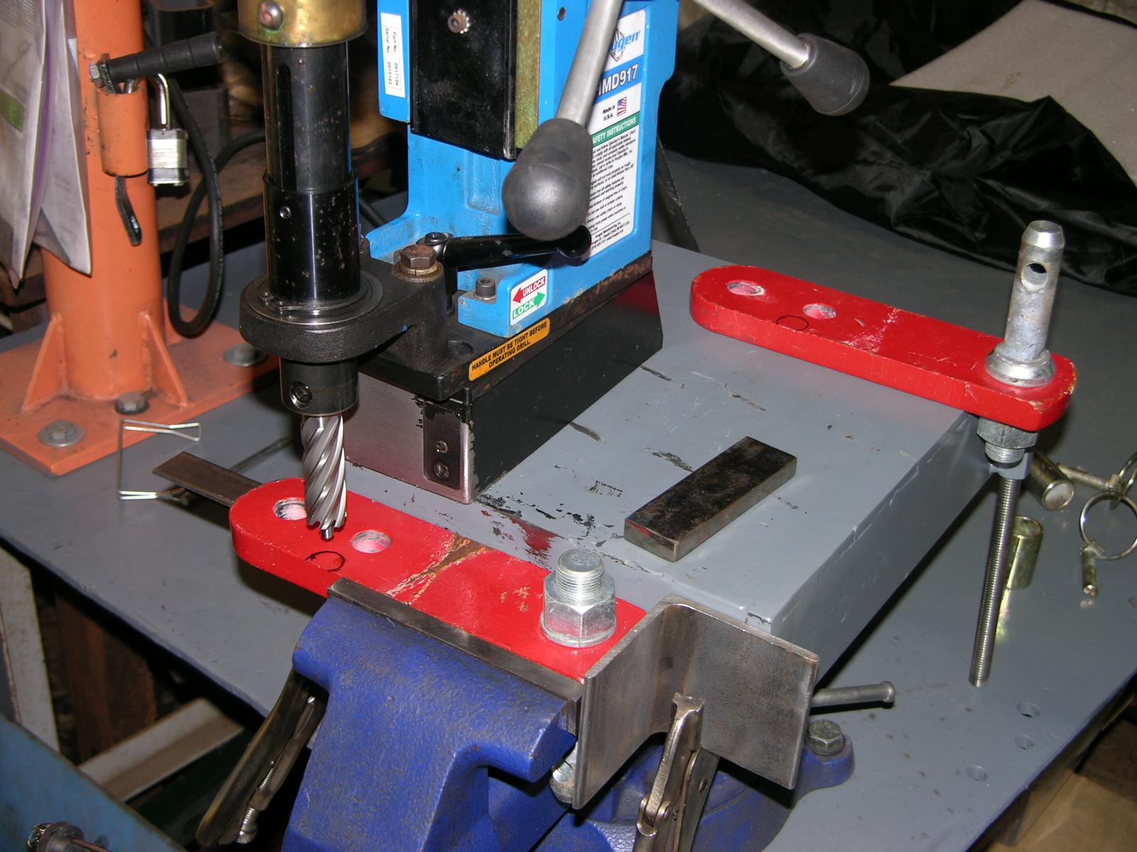

Gang cutting (and REALLY good clamping) is another thing I've done, any time more than one identical part is needed - when I built my modular container roof I needed 6 identical length pieces of 2" square tube, with 5/8" holes near each end holes also needed to be exactly the same distance apart so 3 separate 8' wide modules could be bolted together after welding, to make a 12' x 24' "half-roof" (final is 24' square) - so by gang cutting all the tubing (pieces were actually shy of 12', so 24' steel left me a few inches after cutting 2 pieces per length) - the gang cut made identical length, then by setting a depth stop on my "MDVT" (Mag Drill Vise Table) I could drill 21/32" holes EXACTLY 6" from each end of each tube (different but similar operation) - DSCN1981.JPG

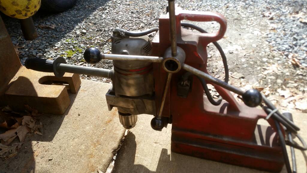

I just chuck my annular cutters into the drill chuck on my mag :)
But it's not very fun to move that drill around, weighs about 90lbs.
