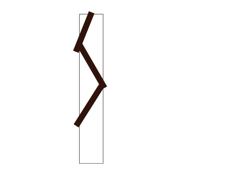

My dad showed me how he did it....
Drill in from the top with a 18" long 1/2" drill bit, but angle it so it comes out one side of the post. Then drill your second hole from where the drill bit came out at an angle down across the post, then back in the other direction, then back again, etc... zig zagging down the post. For a 4' post, you'd have three holes. Run the wire down and out, back in and out, back in and out, etc... down the post. Fill the holes with wood putty. Sand and stain. Or save the sawdust, mix with wood glue and plug it with that. ;)

I used to do a fair amount of kind of high end low voltage lighting on multimillion dollar properties. I would hide wire in posts by drilling holes across them at a 45* angle that met at the edges, weave the wire through it and then cover it up with wood filler and stain to match.
I can try to draw a picture if you can't visualize it from my description.
EDIT - MossRoad beat me too it, exactly what he said.
   / Drilling Hole Down the Middle of a Four Foot Long 6X6 #25
I am surprised that there's not too many discussions or pictures of that out there on the ol' inter-web thingy. I searched and only found one, so I drew it up simple.

I slapped myself when my dad showed me that.... one of those things I should have figured out myself. :confused3:
   / Drilling Hole Down the Middle of a Four Foot Long 6X6 #28
thats a great method!
