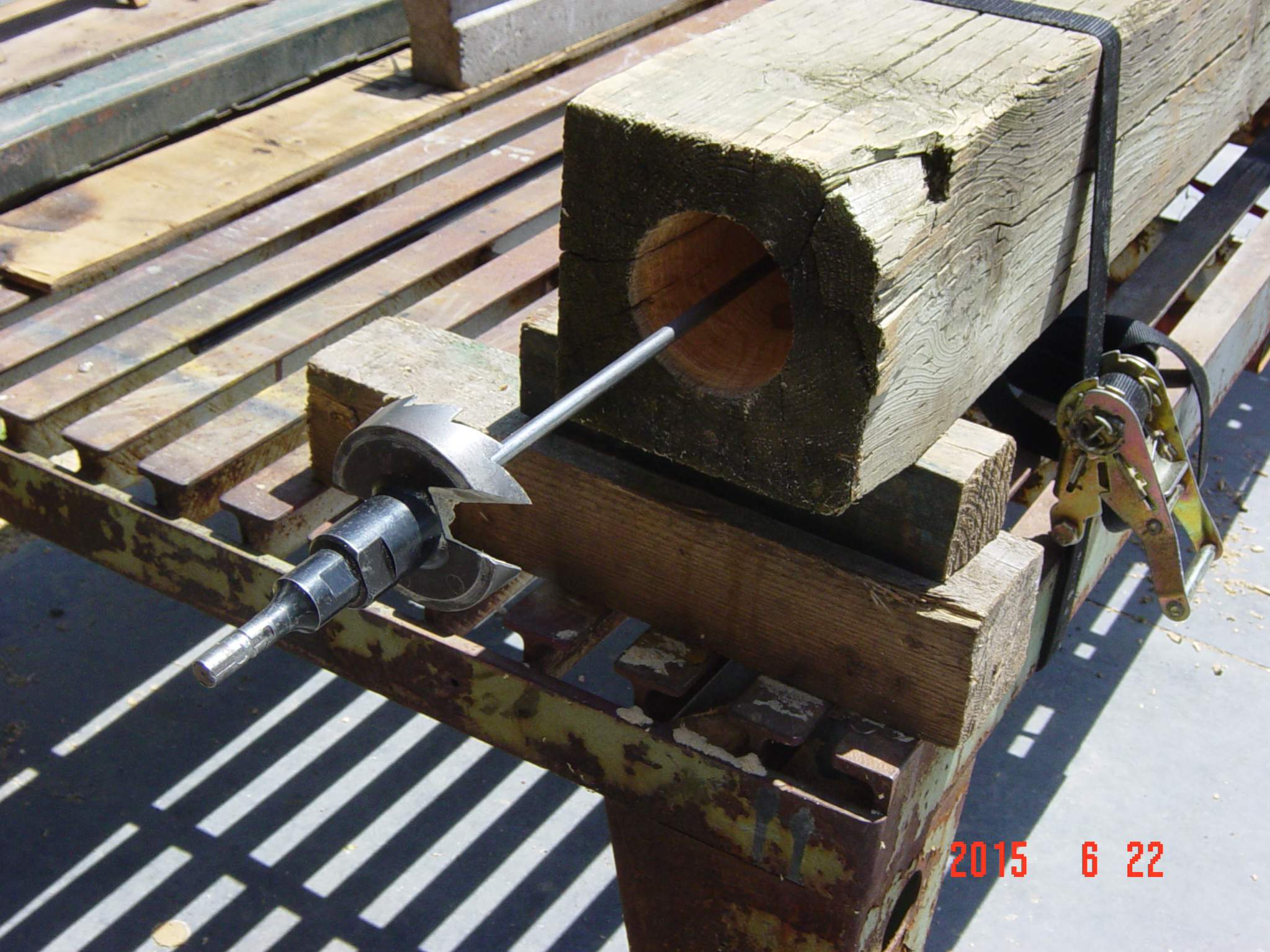

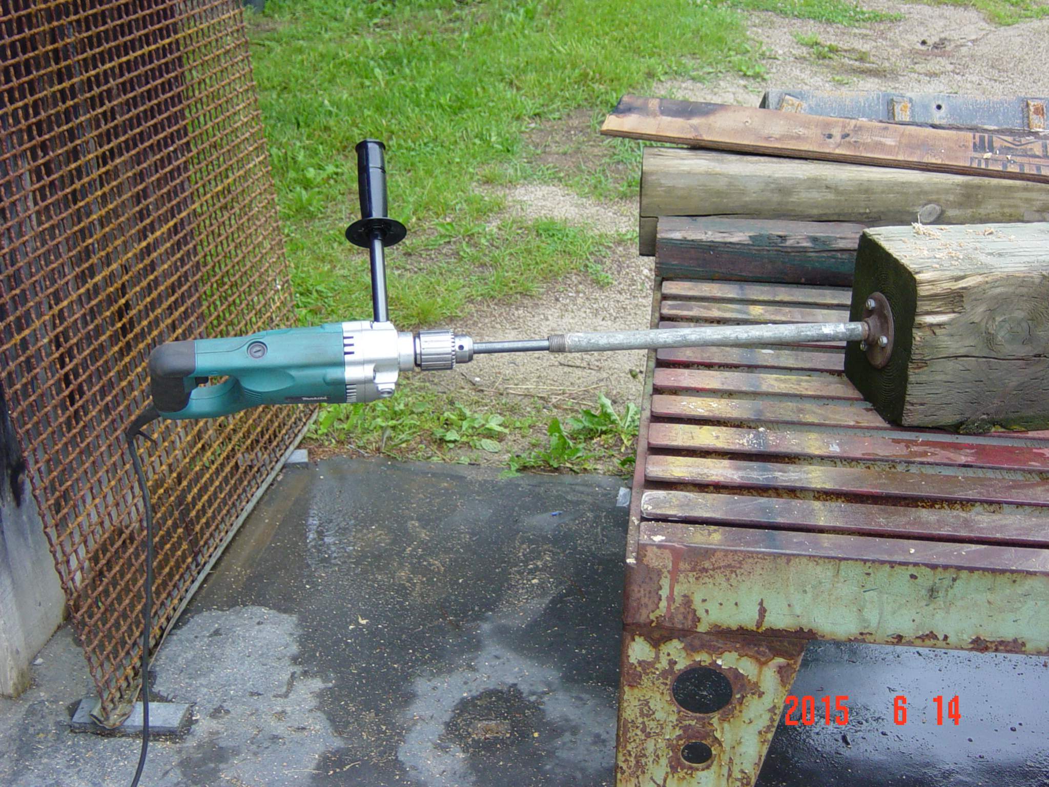

Well, I got some nice 1/2" rod and had a friend weld a 1/2" bit on to it. Should have gone larger on the bit, but I didn't think of that.
So I drilled through it, first with a cordless Ridged Drill and then a 110v Makita Hole hawg type of drill.
I was not too far off, but not good enough. I realize the 6x6 is not going to be big enough anyway. I played with the large bore cutter and the amount of material left is just not enough. A friend has a surplus piece of 8x8 PT, so I will try again on that.

Well, despite the jig I built to keep the drill on course, The best I could do was come out two inches from centre which was not good enough. I thought I would give it one last try and went the other way, hoping I would hit the hole from the other end, which is remarkably what happened. So that battle was won.

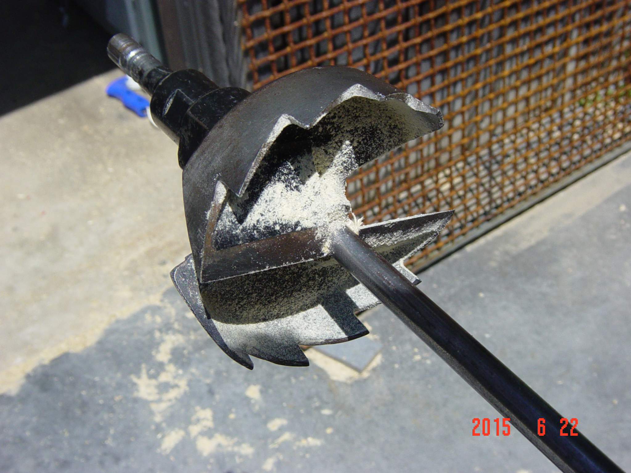

I replaced the screw in the bit with a 3/8" rod used as my pilot.
Then I went from having very fine saw dust and slow going with the big bit, to it catching and almost ripping my arm off.
Now I think the bit needs sharpening as I am making very poor progress.

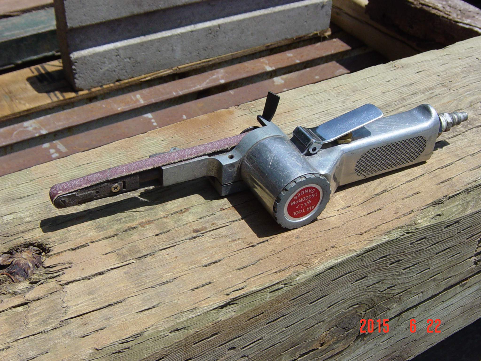

Does anyone know if I could possibly sharpen the bit with that small hand held air sander? I don't suppose the outer teeth would need to be very sharp, or?
