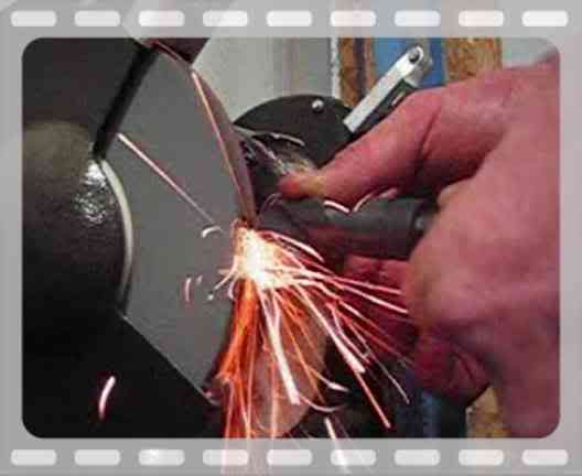

I would also add that you can blue the drill bits when sharpening them, I just use straight water in the water troth on the grinder to keep them cool.
JB.
