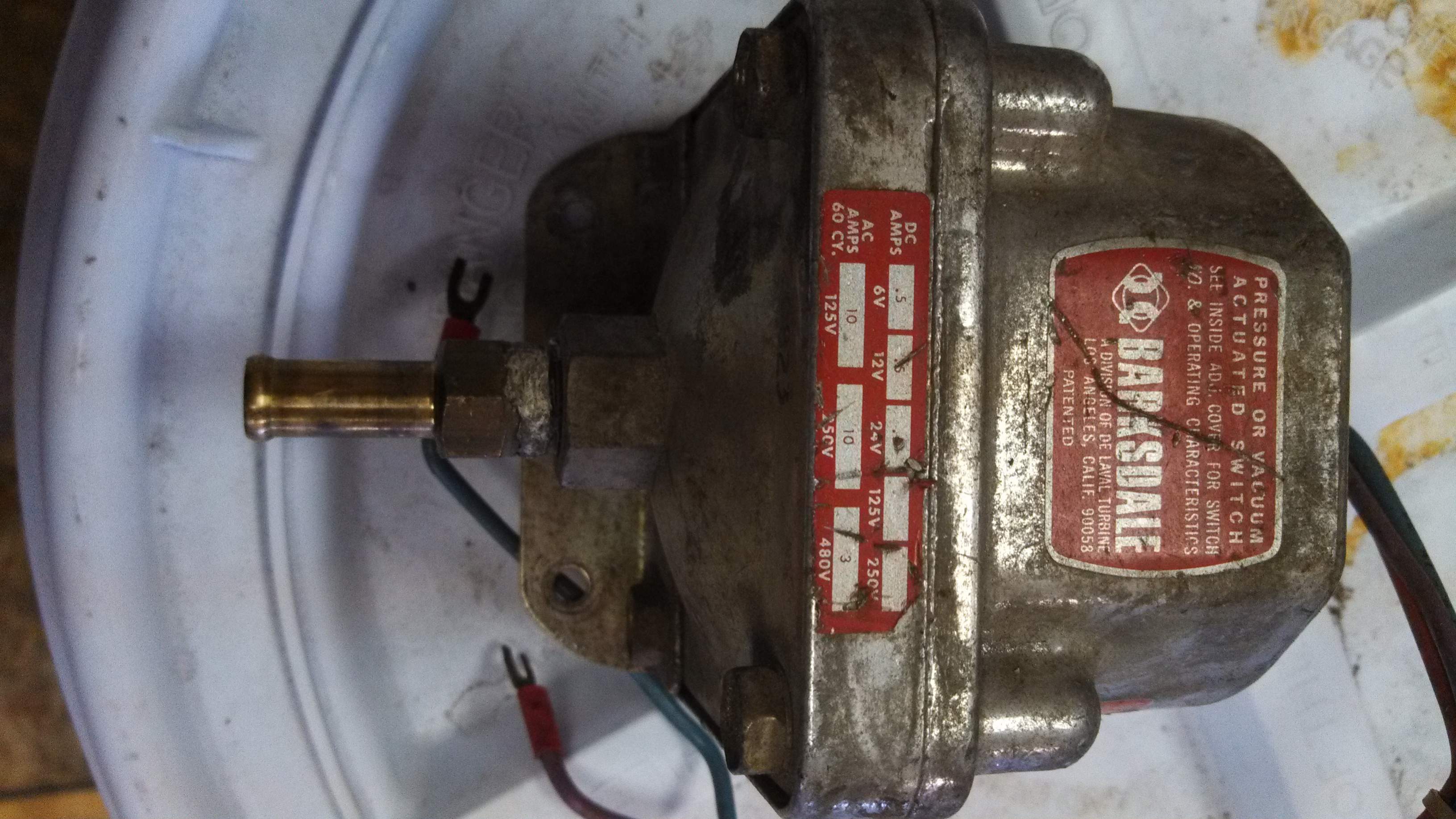

Any ideas for activation? Like a through beam with reflector? Kinda like a garage door safety sensor. I'm sure they offer them in 12v. Most of them are 110V or 24V.
The through beam would work. You could also stay with your hose idea and may be able to rig up something pressure activated tied to the hose. A pressure switch tied to the hose could trip when you drive over it. Like someone else said make sure you don't use air in the hose because it can compress and may not give the pressure rise you are looking for.

This switch will do what you want. Use 3/8" air hose and you have to plug the other end, no need for liquid.
Barksdale D1H-H18.
If you are going for a 12v DC latch I would stop by a junk yard and get an electric trunk latch, make sure you get the plug too, will take all the work out of the project.
